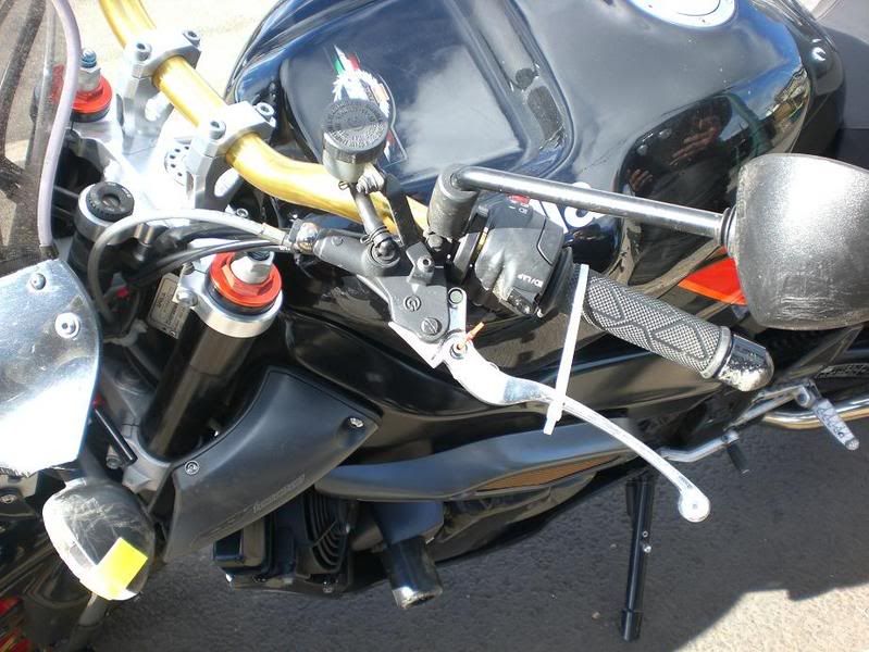

Lissa
Just Ballast
Lissa's Avatar
Join Date: Feb 2006
Posts: 4,381
Default Re: Flip up levers
Tilt's Tuono with our pattern brake lever.................mechanism removed and turned upside down and held in place with a couple of cable ties. I think our pattern levers cost £15 for the pair from our local independant bike shop. For that price and for the 'getting yourself or your mates out of the sh*t factor', how can you really not bother to carry some.
