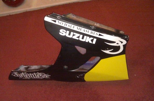

With the application completed and in the post today, I turned my attention to getting the bike ACU compliant.
Starting with the belly pan which needs to be able to hold half your engine's oil and coolant.
Unfortunately I had hacked it up somewhat in my eagerness to get it on the bike!!
I had made a hole to clear the exhaust and also taken a bit off the bottom lip to clear the side stand, which is now off.
I got the usual fibreglass kit which was ok but produced a pretty thin layer even with two layers down.
So for the lip rebuild I did the usual two layers of stranded matting and finished it off with a layer of old t-shirt doubled over the first two layers. Now it looks a lot meatier. I think I will put another "t-shirt" layer over the middle hole too just to be safe.
Not pretty from the inside but it'll do the job.
Then some more toys arrived, so I'll be getting busy with these to lock wire the usual suspects of oil filter, sump plug and filler cap.

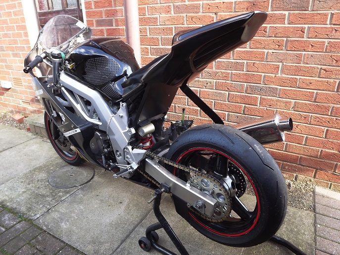

So the only major change is at the back end.
RVRacing made me a subframe and after a quick splash of paint she's nearly ready. I have a plate to be sprayed and bolted on to rest the ECU etc on.
So here's what it should look like eventually:

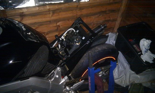

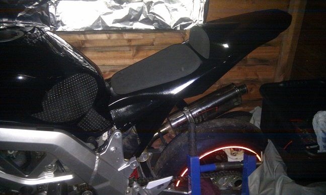

Snuck into the shed on monday night and finished the seat area.
Tucked the electrics onto the plate as best I could then fitted the new exhaust hanger.
The seat went on too with the new seat foam:

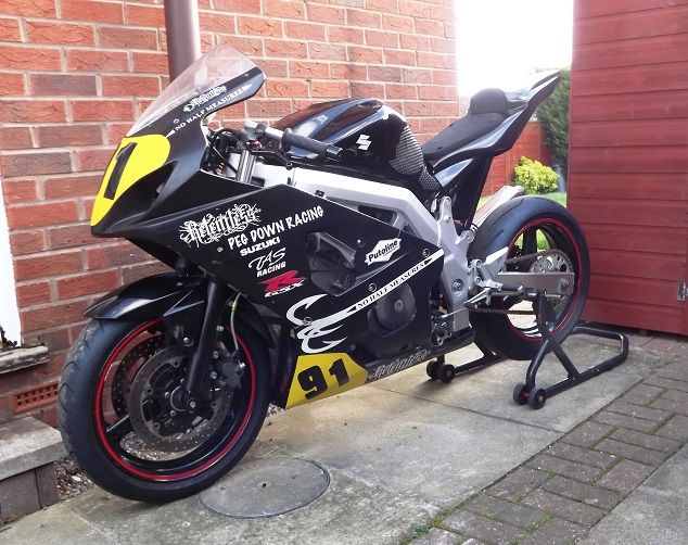

I've also applied some yellow vynil to the belly pan for the numbers:
Will be racing with NGRRC at Cadwell in May #91 and hopefully a race in April at Darley but thats a maybe at the moment!

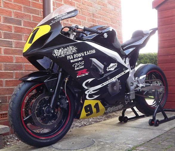

A week to go before first trackday, oil changed, original dog bones re-fitted and a good de-gunk all round. Took some photos whilst she was out:
