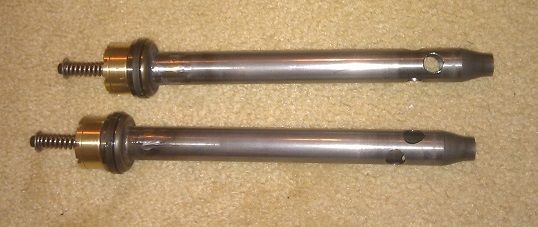

Finally got the forks back together after I got a friendly chap at work to braze the compression holes shut:
Initially I felt the 9.0 springs might be too much but after replacing the top spacers using a stack of 5mm thick spacers we (SVGTI came to help measure!) achieved a static sag of 10mm and Rider sag of 23mm with the adjusters FULL in, full out = 36mm of rider sag, so a healthy range to play with at the track.

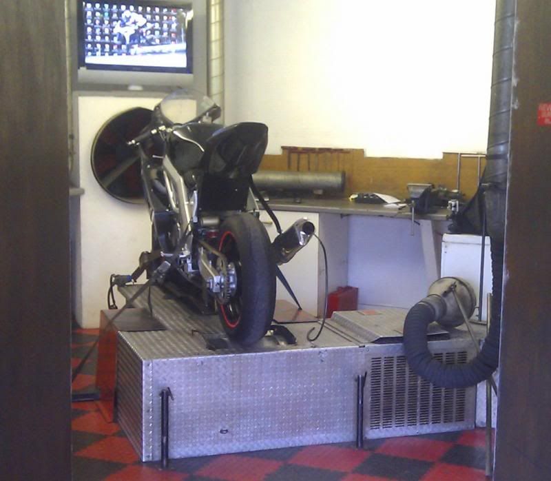

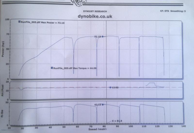

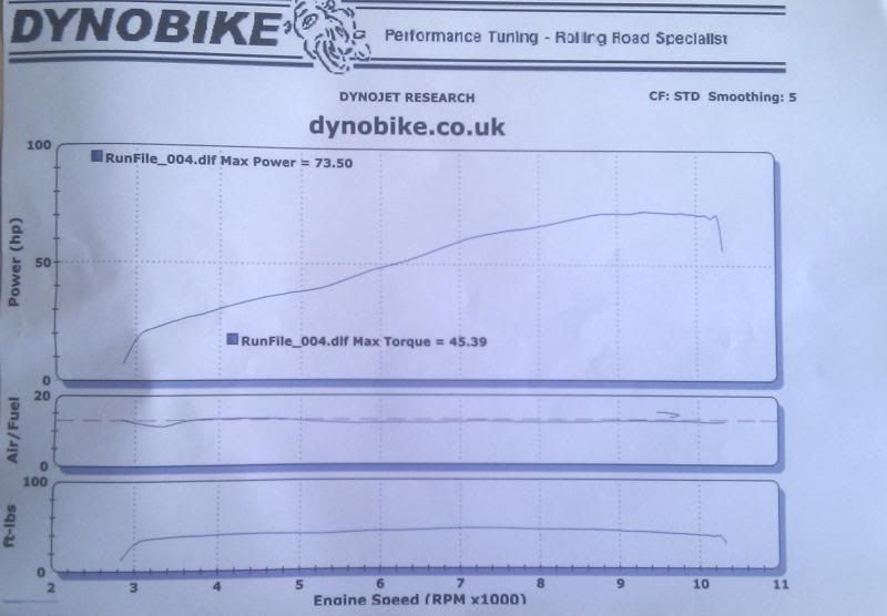

Today was dyno day!
The aim was to see how the bike is performing, making sure its making standard power at least.
And also to get some help diagnosing Andy's (SVGTI's) curvy model which was running poorly last time out. Thankfully we now have an answer and it seems a poorly CDI unit needs replacing on his bike. (See the wanted section!)

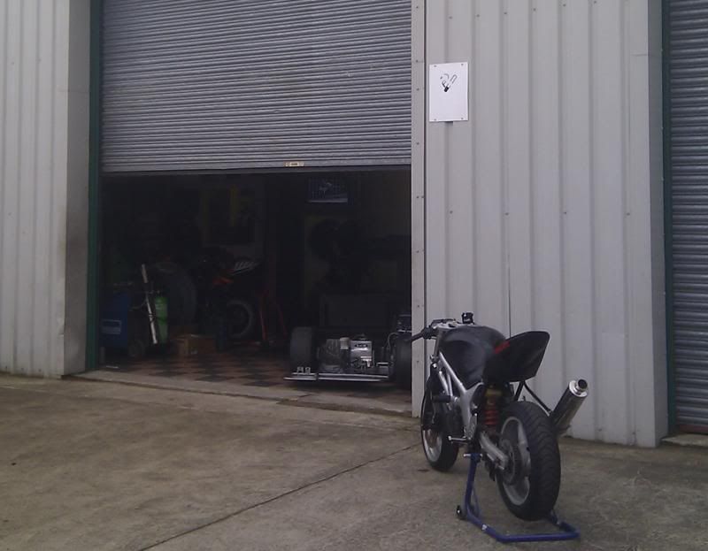

We went to see Paul at Dynobike in Malton: http://www.dynobike.co.uk/
An established dyno test centre, with 15 years bike and car experience.
The good news is that the bike made bang on minitwin power, 72hp at the rear wheel, its running a standard ECU, beowulf can with baffle in, pipercross air filter and with the snorkel in place.
Dyno printouts:

Pics:
[/URL]
[/URL]

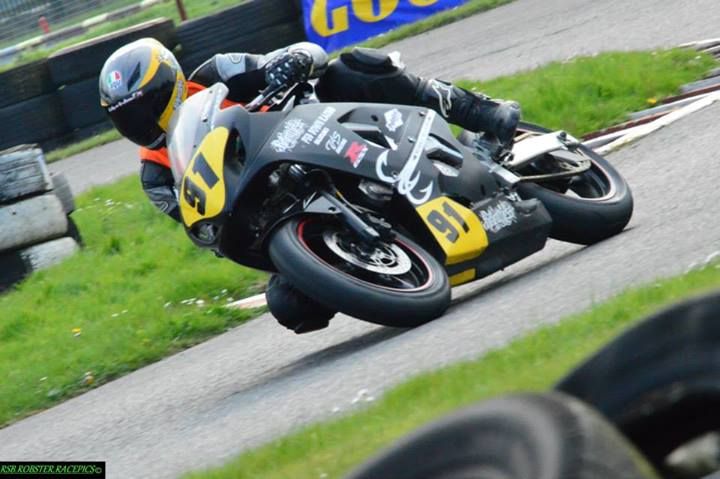

Some pics thanks to Robster Racing Pics:
https://www.facebook.com/pages/Rsbro...78246038889865

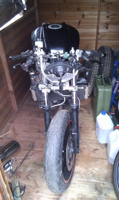

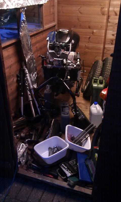

Tonight I set about with the job of fork swapping.
Before:
So I stripped off the right clip on, removed the steering damper and pulled out the forks.
It turns out that it may be only one fork (The right one) that is bent, I will have to find a straight edge to prove the left was ok but I carried on with stripping both forks.
Thankfully the internals all came out nicely so I moved onto the new ones.
I'm a little concerned the new ones have misting of oil on the stanchions after bouncing on them, just a very fine rainbow film shows up but apparently the seals were done already??
So with them all apart, and no new oil arrived yet, I set to taking the exhaust end can apart to try and hammer the entry piece to somewhere near straight again. That was a major pain in the bum but its near enough now. Just needs new rivets and a new jubilee clip thingy to join onto the link pipe.
By then it was dark so I packed up the shed:
Hopefully she'll be ship shape by the weekend (Bar the fairings) if all the bits arrive this week!
