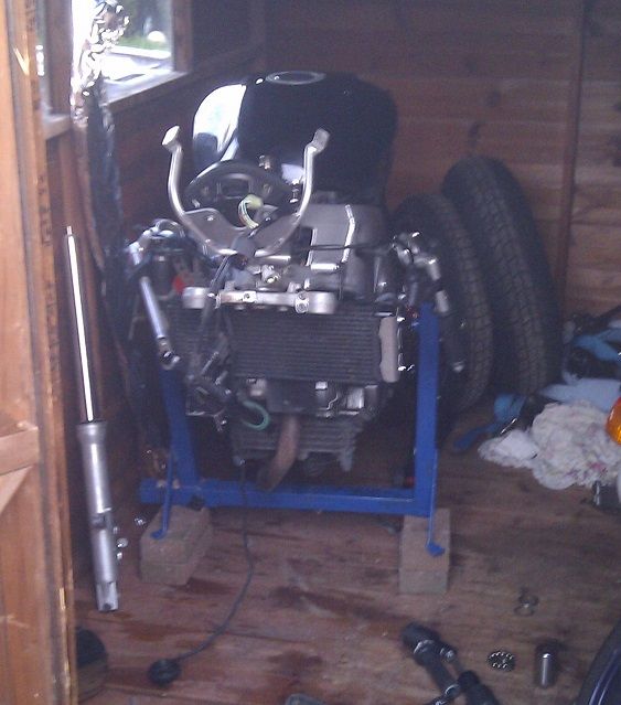

Tonight I set about with the job of fork swapping.
Thankfully the internals all came out nicely so I moved onto the new ones.

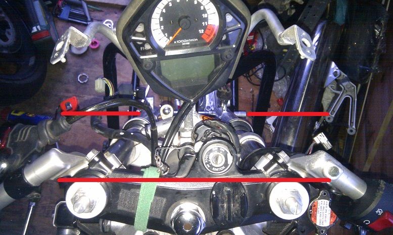

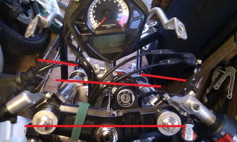

So more fears confirmed tonight, after I discovered that the new forks weren't going straight in the yokes, I use the old bent fork to lever the bottom yoke a bit straighter, enough to fit the new forks and see where any further issues were.
As you can see the bottom yoke is rather fubar'd:
If you have one lying around looking for a new home, give me a shout please!!
Cheers!

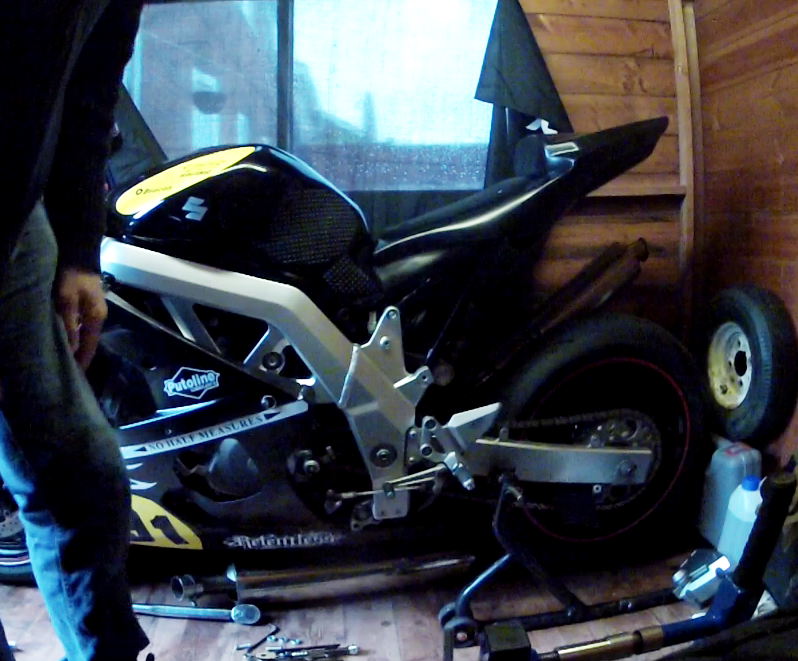

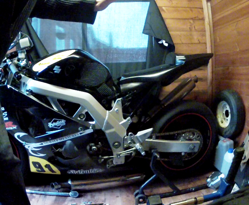

With the stem / bottom yoke arriving on friday, I set to with the swap today.
Praise be to the ABBA stand, I fixed it to the holes in the frame that I removed the bent crash bung bar from and used a few bricks to keep the front up:
The new part was easy peasy to fit and I also used the bearings from the replacement just in case I had damaged the originals in the crash. I kept the races in the frame though.
After which I regained some straightness:
Next stage, is to fasten all the front bits back on, then rebuild the exhaust end can after I hammered the inlet back into shape.

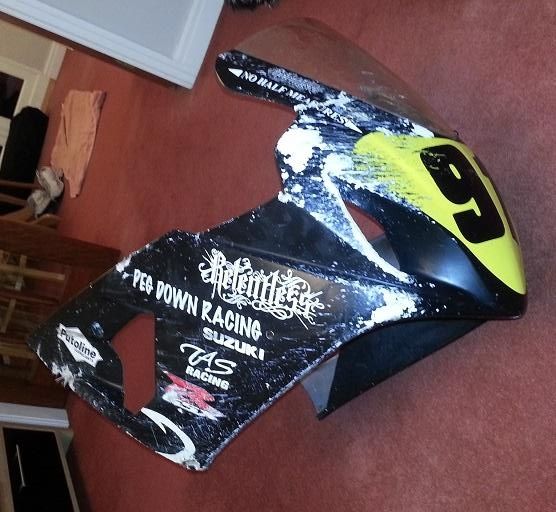

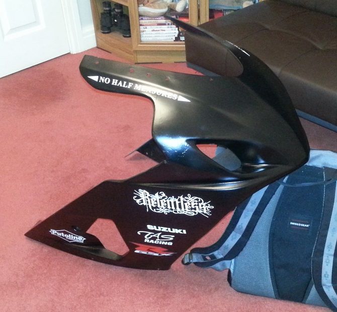

I had found some cheap replacement fairings to use instead of trying to patch up the original ones. (I'll maybe try to make something of them over winter)
They had a nasty paint job on which I tried to rub off.
So from the beaten up original:
To the replacement:
Not to bad considering its a rattle can job, it'll certainly do until the next time it makes a bee line for the gravel traps!

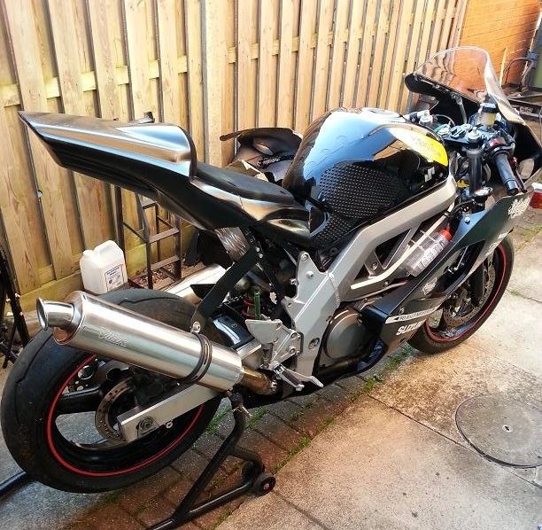

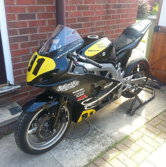

I thought I'd better post up a picture of the bike after its mini-rebuild.
Considering the weather forecast is heavy rain all day for tomorrow, it may not stay looking like this for long!!
I am actually looking forward to the challenge of wet weather riding on track. Its about time I faced my fears and see if I can set a reasonable pace.
The screen is new, being a dubble bubble chinesey one but bought from a uk seller for £14 delivered.
The yellow "fillets" on the tank are there to cover the gravel rash from Darley!!

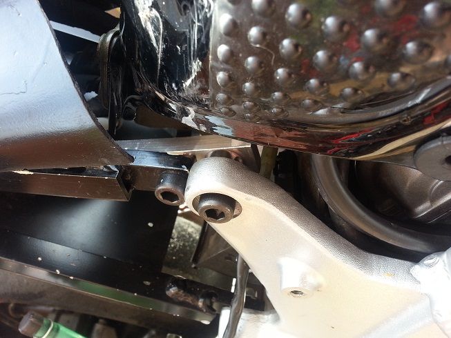

However it was the first time I'd been back since raising the seat using the new subframe and I have a feeling it hasn't helped handling much.
It is great for my legs which were aching after just one session before, but to regain some handling I decided to use some engineering in order to settle on a compromise:
Before:
After:
So it doesn't look as good but hopefully it'll let me carry the speed in the corners better.

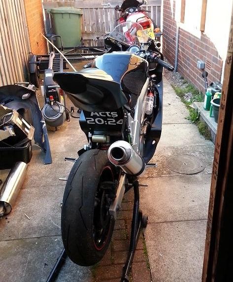

Today I spent putting the bike into "Hill climb" mode.
This included, removing the fairings and clocks. Pushing the clip ons out for a wider stance. I still have to come up with some number boards and drill the oil hose bolts for lock wiring.
