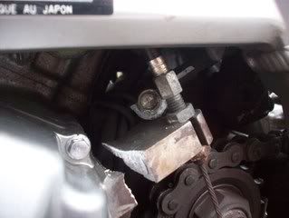

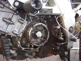

right, this is the major damage
just above the broken off bit of the magnio cover you can see the wires going to the magnito, these are the wires that got severed.
To get the magnito cover off, the connection to the magntio had to be found, it was under the seat unit. This took alot longer to take off than expected becasue we couldnt figure out why the haynes didnt tell us how to get off the tail section properly. The answer, non standard undertray!
The rear wheel was taken off to change the sprocket. There is slight scratching on the sprocket carrier, but nothing major.

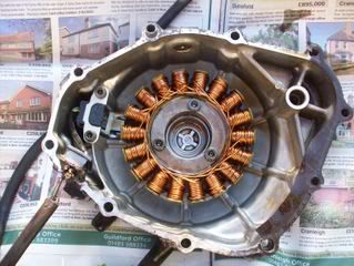

Got the magnito cover off, and found the magnito... not that it was hiding or anything.
The bike with no cover..

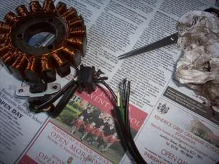

Heres a close up of the severed magnito loom wires

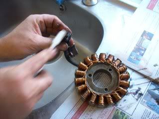

Alot of scrubbing to get scott oiler lube off

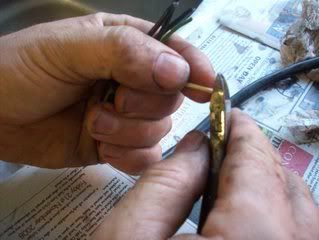

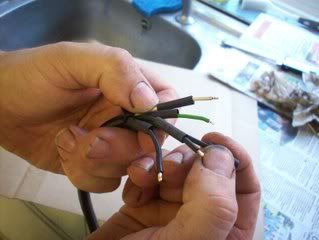

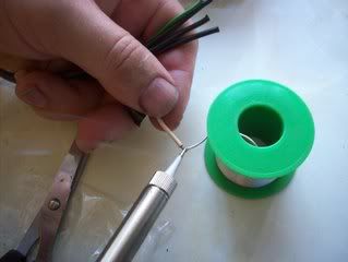

Cutting down the wires so they can be soldered
Bit of soldering action

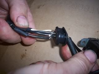

Add abit of heat shrink wrap
Solder the wires back together

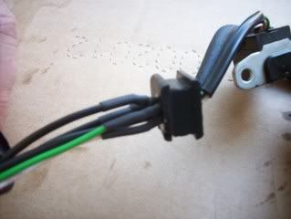

done! nicly soldered and back to a working state!
heat the heat wrap, looking nice!
Add the bigger heat wrap to complete the look! perfect! Repairing this took about 3 hours, very fiddily. But saved a packet, im sure if I took it to a dealer they would have just ordered a new magnito!

Default Re: Chain came off HELP!
Lol could have told you you'd severed the crank position sensor wires that control the spark
