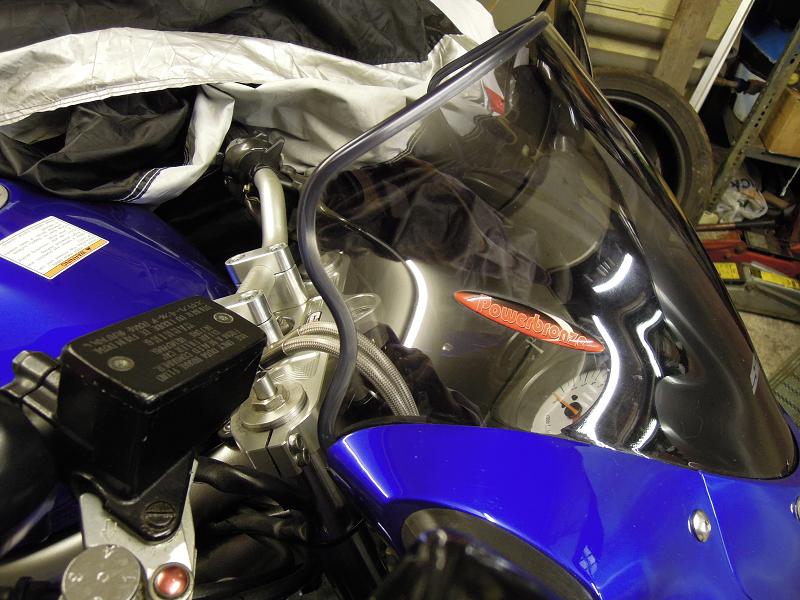

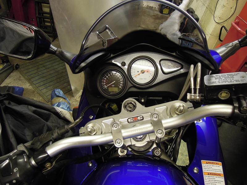

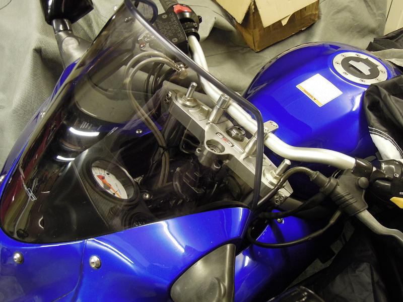

I fitted a comfort kit to my dads curvy SV, and had to cut of the two swept back parts of the screen, and also made a slight cutout on the right hand side for the master cylinder (we used the naked style master cylinder with built in reservoir). I'll take some pics later.

Sorry for lateness! The screen is a Powerbronze light smoke. Aftermarket ones are more suitable for cutting down as they don't have the wide lip moulded into the edges like the OEM part does.

Mikerj that looks really neat - I'm definitely gonna try and find a brake setup from a naked. Always thought that clear plastic cylinder looked a bit wierd! The change in handlebar position looks good too, I can't wait to get mine on
