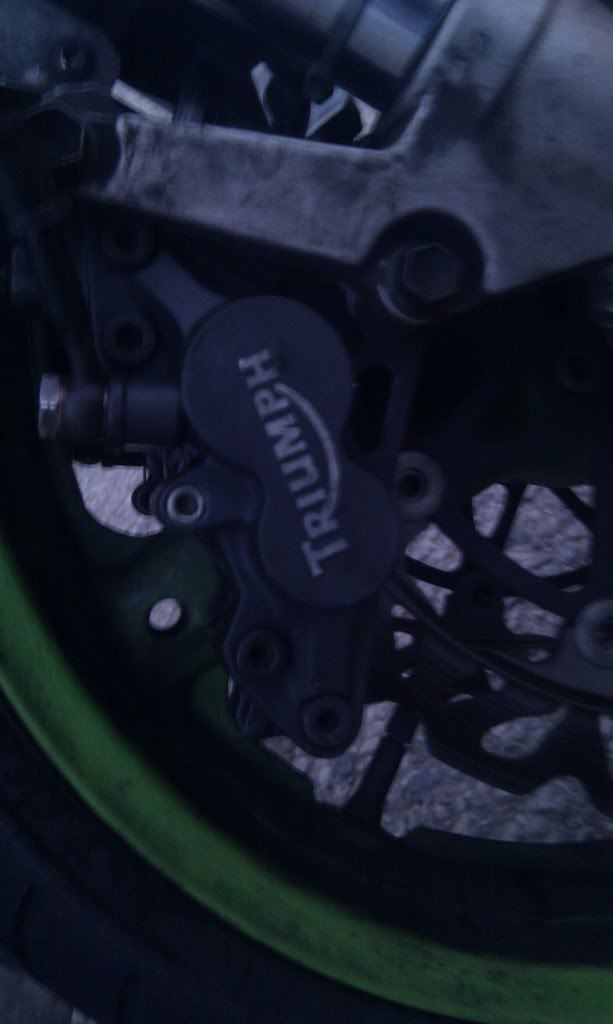

Mark is correct ... for his bike(s).
Pic above and other info suggests sprint did actually have different calipers to rest of triumphs at time.
the Daytona, Speed Triple, Sprint ST and Sprint RS all run the same brake calipers, now you may have some of the earlier T3 engined bikes calipers which were fitted with either 310mm discs or 296mm discs (the T'bird sport had 310mm) and they are different, but all the T5 engined bikes calipers are interchangable.

In pics I linked above they look very different between speed 4 and sprint RS

90 mm centre to center , measured by them and me, can move pistons with fingers, really nice guys and haggled a bargain.also left with some parts for my golf
