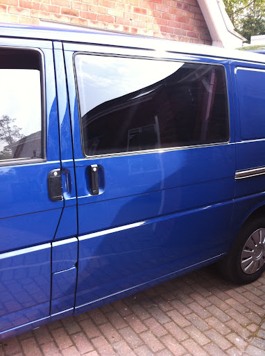

update: Managed to get 1 x side window fitted on thursday night and left overnight to set properly in time for the weekend - hurrah!
Cut hole out of side of van with drill, jigsaw and then tidy edges with angle grinder/file (super brutal thing to do to your van!)..
apply the glass glue sealant stuff and stick it to the van
then later on when it's all set take your 'holding glass in place' device off (in this case ratchet straps and chunks of polystyrene)
test the Ikea Dioder LED lights to make sure they work with the existing vehicle interior light wiring
Have a beer, go to bed, wake up and carry on - drill/cut holes for LED wiring to go through, stick LED's to roof lining, connect all wires and test again before re-fitting roof panels
Re-fitted panels with lights
Stick some carbon fibre wrap vinyl on the bonnet for stone chip protection and added chav appeal
Claim your pitch with ridiculous number of wind breakers
Set up out door kitchen area & then realise that your cooking pans are too small for intended foods
balls
That's about it for now - still got to fit the other window and finish carpetting exposed metal, as well as fit the Saab leather seats... then hopefully order the proper bed (air bed was surprisingly comfy all weekend though!) and wardrobe
Will report back with more pics later

Nice Paul, I'm still watching. Window looked fairly straight forward however, I'd like a lighter tint to it. I've seen some of those full conversions being auctioned on eBay and go for less than £1k which looks cheap considering the price of some of the furniture.

Great job on the window ! dont slam the door too hard incase it falls out tho

Blimey! I should have checked ebay a bit more thoroughly lol. Some people do buy cheaper ikea units and adapt them to fit their van but I'll be getting the bespoke stuff from t4life in the next month all being well
Not for the first 24 hours at the very least!
