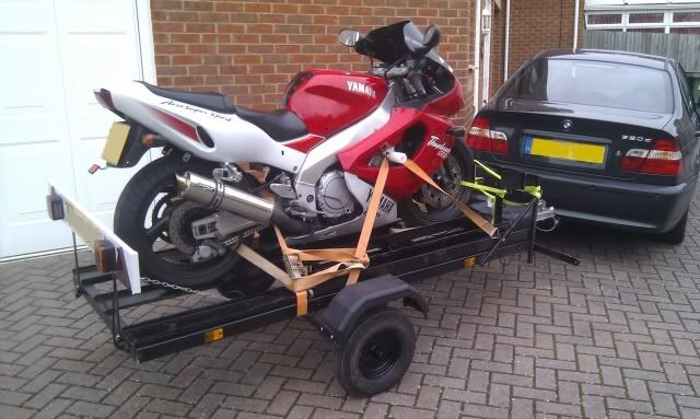

Righto thanks for that, I shall get on with that this weekend if I have time as I have to go to exeter first thing sat.
It should be ready for a road test with a bike next weekend if I get the last little bits of welling done and some paint slapped on in the week

FINALLY!!!!!! ITS FINISHED!!!!
Got back from road test about an hour ago. Tows well but there is no way in hell im putting 2 road bikes on it at once, maybe two crossers but that's my limit. nothing really wrong with it I just don't think i would feel comfortable towing 2 bikes I'd rather shuv them in the van.
Towed it about 3 miles on really rough country roads and it moved slightly, the addition of another racket strapped solved this solved this so off on the motorway i went. Did about 10 miles, bike didn't move, trailer didn't snake or bounce, everything went well .
