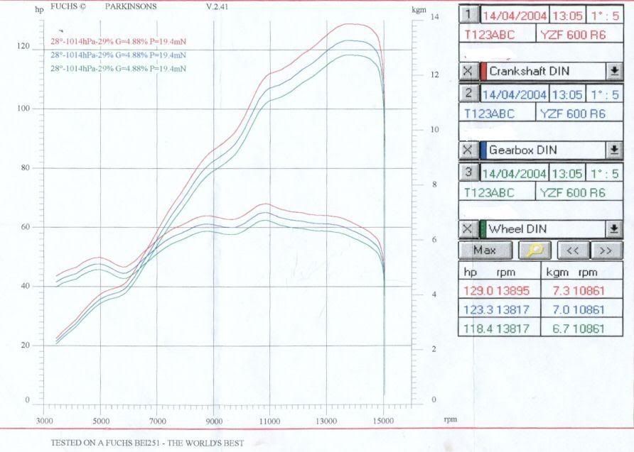

No... I did research into the subject and it turned out he was right. If you want crank HP you need to take a direct drive off of the engines crank and if anything else says its measuring crank HP its a guess.
Bearing in mind dyno runs are generally done with the back wheel, that didn't need research, that is bleedin obvious!! You don't need to measure crank HP, you can take RWHP and add in a fudge factor to get (estimated) crank HP.
Point is, many rear-wheel dynos will give you a printout that is actually the calculated crank HP NOT RWHP as it makes the customer happy!!
Hence why you need to ask ... a tell tail sign is if your bike is stock and producing manufacturers HP or better, it is safe to assume it is 'dyno tuning' not your bike
Sadly 'dyno tuning' (purposely poor dyno calibration or giving you estimated crank HP instead of RWHP) to make customers happy is rife ...
If it doesn't say RWHP on the chart ... you are prolly safer to assume it is showing crank HP until proven wrong ...
Old 19-10-08, 11:33 AM   #43
Blue_SV650S
Default Re: Had my bike dyno'd the other week.
No mistake on this one ... as you can see the 3 lines are identical, just 2 of them have 'fudge factors' ...
You can see if given only one line you wouldn't know which of the 3 it was
