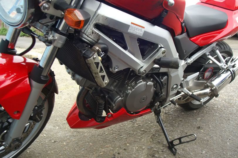

The suzuki bar ends are only held in with a rubber compressed bung, the impact with the ground was enough to bend it out a little and damage the tank, this is the same as on the faired pointy bikes (not on faired curvey as they had solid handlebars).
Ah, that makes sense! Surprised it would cause that damage but it certainly explains it.

Glad u came out of it ok.....i went down on the same side of u but at 20 mph faster. R&G bolt snapped and i ended up with smashed fairings. Drilled my gear selector and reattached the rubber and it works fine

I 'bent' my R&G when I had my off in April - forced into the kerb at about 30mph by a white van
If the bung was the same width all the way down then it wouldn't have bent quite so much - on the other hand it might have snapped off like yours
I guess it depends on a number of factors as to whether it bends or snaps
Give Steve Jordans (in Great Bookham nr Boxhill) a call or Lamba (in Carshalton) if you need parts
If you can get a new lever, there will always be someone at Soho who can help you change it
As an aside, where were you doing the bikessafe course ?

I have also done the repair to the lever, done well it works fine. A new lever will cost over £35-£40 ish. Put a request in the stuff wanted section, I could have had a rearset and they only wanted £20 shame it wouldn't fit my nekkid bike (it was off an s)

Seeing the photo of your tank, I was sure you had broken the lockstop, but carried on to read TSM's explanation. My bike (right side crash) had a bent bolt for the bar end (I hammered it straight and am still using it).
I had to replace my brake pedal and did steps 1 & 2 but found I needed a huge allen key for step 3 which I didn't have so I got my dealer to do it
If you dont pull the dent in your tank, I'm sure TSM has suggested a baglux tank cover.
Please keep us updated on your R&G's

Yes TSM has explained whats happened. The bung in the end of the bars bent out and hit the tank.
Rang my local suzuki dealership and they want £42.23 for a new gear arm which i think is a bit steep. Going to try and do a bodge with a bolt either tonight or tomorrow, worse comes to worse and i some how mess it up it doesnt make a difference

sorry to hear about your off dude. As least it was a slowish one, shouldnt take a lot to sort your bike out either. That dent in the tank should be able to be poped back out (i dont think the sv tank is double skined).
