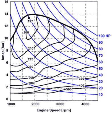

A couple of things -
As Sid said, the old "56mph" economy for cars thing was purely a legislative speed for fuel economy testing (Euro used to be "urban", 56mph (=90kph), 75mph (=120kph), weighted 40/50/10% to give a combined fuel economy, USA used to be city/highway weighted 55/45), it is now done on a drive cycle consisting of "urban(x4) plus extra-urban" as here
but that's by-the-by, and doesn't apply to bikes anyway. It just happened to be that of the test conditions used, the constant 56mph was the best economy, but didn't pretend to equate to the best economy point for the vehicle.
As for economy generally, it depends primarily on where in the load/speed range the engine is working and what the demand is.
Brake Specific Fuel Consumption (BSFC) graphs show how the amount of fuel required to give each kW output varies, it is a function of the various efficiencies (volumetric, thermal, mechanical, chemical) involved.
This one is for a VW 90PS diesel, but shows the principles (I chose this map because it already had the constant power lines shown).
If the road load of the vehicle is, say, 20BHP (15kW, typical of around 60mph), it could run at nearly 4000rpm in a low gear and use 400g/kW.hr of fuel, or it could run at 1750rpm in a high gear and use 230g/kW.hr and get much better economy, 6kg/hr vs 3.5kg/hr, and if it was indeed 60mph that would be something like 36mpg vs 58mpg.
Road load is the total power required to overcome drag. Rolling resistance for a car is typically something like 1.5% of the weight, so a 1500kg car needs about 20-25kgf (200-250N) to roll it and is roughly constant, then the aerodynamic drag rises with the square of the speed,
F=(½.r.v2)Cd.A ,
where Cd is drag coefficient (car around 0.3) and A is frontal area (car around 2m2), r is density of air (1.2).
So at 60mph or around 25m/s a typical car road load is around
P(kW)= 25m/s x (250N + (0.5 x 1.2 x 25 x 25 x 0.3 x 2)
Road Load = 12kW which might not sound much but is about right. Roughly half and half rolling resistance and aerodynamic.
A bike has much worse drag coefficient, more like 1.0 I believe.
Basically unless you know the BSFC map and road load curve, you're guessing, but as the others say, lowest speed comfortable in top gear usually gives about the best economy.
