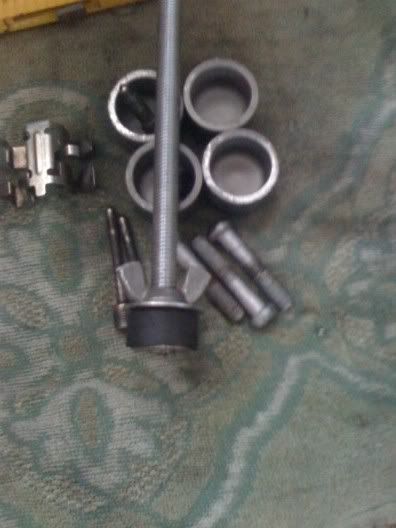

Just had the exact same trouble mate with my new GSXR calipers. In the end i put the calipers in really hot soapy water and left them for a few hours. Then i used my own version of a drain plug. Easy to make with a few washers some rubber and a decent sized bolt.
Make sure the washers fit inside the piston. Push the rod in tighten up the nut therefore compressing the rubber making a strong grip and pull like crazy and pop. I was celebrating like a prat when i got one out . Make sure you dry them off first before using this system otherwise you'll have no grip.
