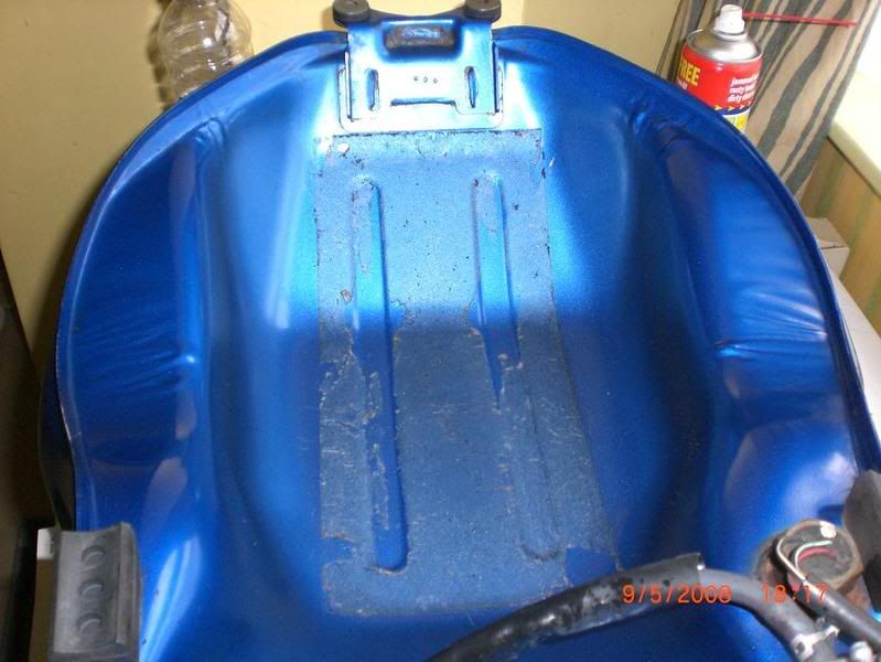

While I had the tank off I also defoamed it.
