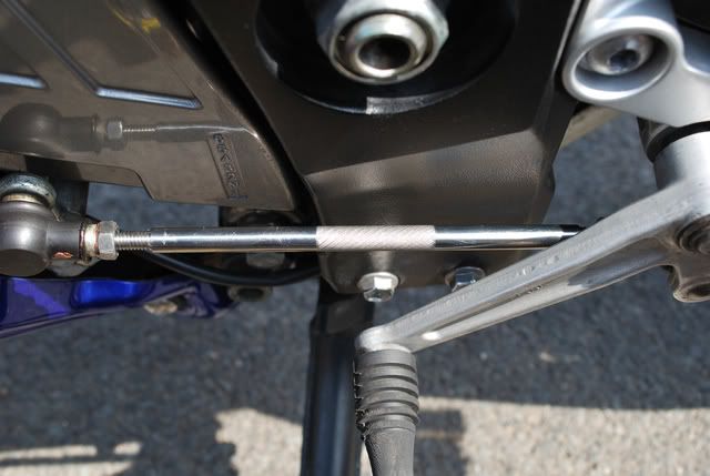

Just fitted this to the SV in place of the tatty old one which was a bit wonky. I ordered it, titanium, bespoke size, thread length, knurled barrel, on Tuesday evening and it arrived today, exactly as per my spec! Got it from this guy on Ebay Twelve quid posted 1st class!

Yeh, I know, bit of bling, but what the hell. To be honest, what with the lower footpegs, new boots and my wonky knee, I was having a lot of trouble changing down. This new spangly bit allows the gear lever to be a lot lower 'cos it's 10mm longer than stock.
If you take it off there, you can reattach it at a different angle to raise or lower the gear lever.
Be careful, however you do it with ground clearance if you lower it too much.

Tim, all the length of the rod determines is where you can position the gear peg. The SV oem is too short to allow the peg to be lowered enough for me.
A shorter rod would make the position higher, with no change to the effort needed. The amount of effort required would be determined by the distance between where the rod fixes onto the pedal, just below the pivot point. I can't see any way to change that.
