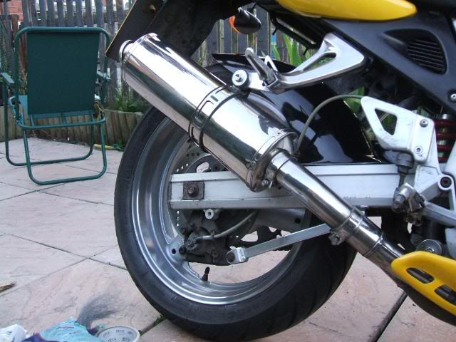

And yes I have done it myself too. got some pics somewhere but its a tad late...I'll post tomorrow if I remember...or even today

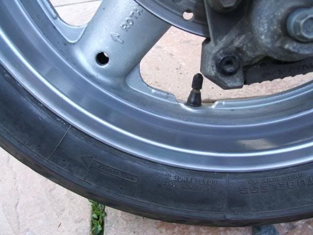

Thought I had some pics. Here we go.
Then tape up the parts you dont want stripping (or be very careful with the Nitromors) & like Dizzy says strip the paint off the wheel, buy some Autosol & very fine wet & dry & polish to your hearts content
Then paint the wheel & also laquer the polished bit because it goes to look like cr@p at the slightest hint of damp. & jobs done. easy really

+1 to doing it yourself. but i wouldnt recommend laquering the whole wheel. with the back wheel i laquered the painted inner section, and left the rim as is, and the front i laqured the whole wheel. now the problem i have now is that the laquer has started to pit like the front forks do, after a year of doing the wheels. the rear, all i have to do is quickly go over with the autosol when i clean the bike and hey presto, job done. now ive got to go over the front wheel with wet and dry and take off the laquer on the polished section!
Old 21-08-08, 10:02 AM   #7
Default Re: polished wheels ?
I have polished rims and forks on the black SV, which is why I did the yellow one. They didn't have laquer on them, and TBH its not much more hassle keeping them that way. So I didn't see the point laquering the yellow ones. I thought they may go like the original forks if I laquered em.

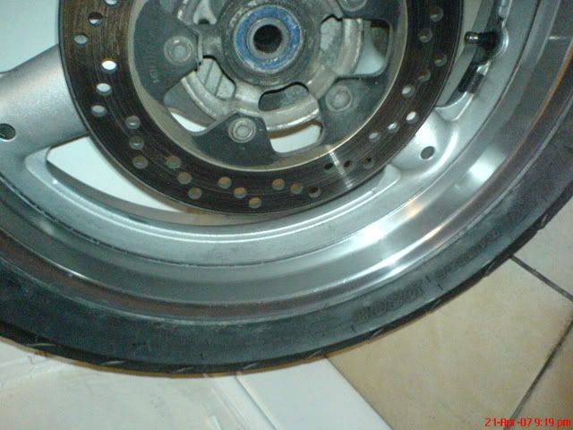

hes a nice example of polished rims -

looks to be a winter project that one !!!!
looks well nice though !!
