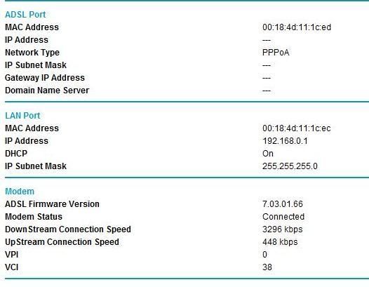

Righto a geek I might be but comms and networking is not my bag...
Our ADSL at home has stopped working, I've raised a call with my ISP and they are blaming the router at my end.
I've done some digging through the router logs and I'm getting "CHAP Authentication Failed" Which I think is my user name and or password being rejected or not authenticating properly.
My router logs look like this :
Sun, 2002-09-08 13:25:19 - Administrator login successful - IP:192.168.0.2
Sun, 2002-09-08 13:25:48 - Initialize LCP.
Sun, 2002-09-08 13:26:04 - LCP is allowed to come up.
Sun, 2002-09-08 13:26:07 - CHAP authentication failed
Sun, 2002-09-08 13:26:07 - LCP down.
Also on the router diagnostics its showing
Its a netgear D834G I've hard reset it and entered all my details in again and I've done a firmware upgrade on it as well.
I'm reasonably convinced the problem is with my ISP but they're blaming it on the router at my end.
I've also been talking with a colleague with a similar problem and we live 1/2 mile from each other so we're on the same exchange so I'm wandering if thats co-incidence or a symptom. I've also been told it might be noise on the line ? The ISP are saying they've checked the and its showing no faults.

Default Re: Router / ISP / ADSL Advice
i take it you work from home and your boss supplies your adsl?
if that's the case have you asked your boss if he has paid your bill lately?
but if the screen shot above is correct then you are connected.... giving this is true then i would be looking at the network card in your computer.... make sure that no one has set the card to static address or if they have they have done it properly.
only other thing is that someone has been playing in your router and changed your username and password... doubble check the u/p.
yes and the bill has been paid.
Its running over the wireless adaptor in my laptop. The laptop gets an IP from the router and I can ping the router over the wirelss from my laptop. All is set to dynamically assigned IP's.
I've reset the username and password and have even been provided with another set of credentials from my ISP to try and use and those fail with the same "CHAP Authentication Failed" error message.
As I said above, it was working I went to the loo and came back and it had stopped and nobody has touched the settings.
