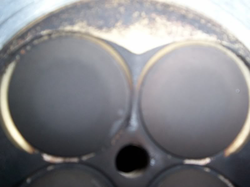

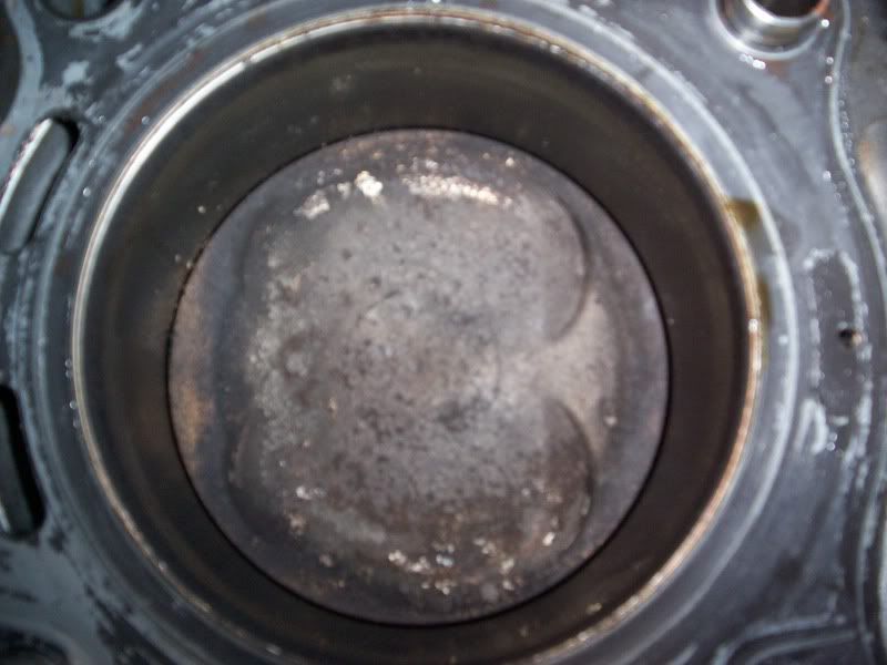

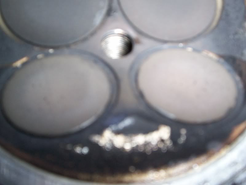

So I bought a 2001 sv650 and the guy told me it had a bad valve seat. He said he was driving it and it backfired and then started to make a ticking noise from the rear head. I never heard it run or anything so I am just going off that. I took the head off today and from what I can tell it looks fine. But I looked at the motor and it seemed like there was a gap between the piston and the cylinder wall. I was wondering if that was normal or not, or maybe its just a gap only on the top of the piston but not the rest of it. What should my next step be? Here's some pictures so you all can see whats going on. Thanks

Looks o.k to me. The gap around the piston is normal, that's what piston rings are for. As for the noise I'd have started by checking the valve clearances.
If not could possibly be a little end.

Alright wonderful. How could I tell if the head has any problems? I don't have the tools to take the valves out. Is there anything visual I could see, or is there something else that could be making the noise, btw the cam chain tensioner seems to be working correctly the cam chain was taut.

The only visuals I can think off checking are damage to the piston crown (can't see any in the photo) and pushing the piston down to the bottom of it's stroke. Then you can check the barrel for scoring.
I'm only guessing but if you press your fingers against the piston crown and rock the engine back and forth gently with a spanner on the crank shaft, you may be able to detect any play in the little end.

Would have been better to compression test it first.
Those marks on the piston aren't valve marks, but they could be the result of detonation.
