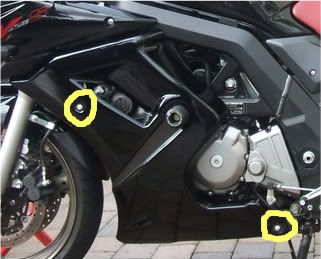

Default What size are the fairing bolts - K8?
Have done a search but can only find threads on sized/rounded off bolts etc.
Have also looked through the Haynes manual and the alphasports fiche.
What size (diameter/length) are the bolts that hold the fairings on (below)?
I need some more as the garage kept mine after my off, gonna get them from www.stagonset.co.uk.

Default Re: What size are the fairing bolts - K8?
Is that true of the two bolts highlighted though Tim? I know the ones that hold the bikini fairing and the side covers either side of the seat have shoulders, but I though the ones highlighted were just regular bolts and the rubber grommets that they go through on the fairing have plastic inserts in them?
Hi Mark, if you wouldn't mind just looking at the pic (or even one of the bolts off your bike) and let me know what size diameter and length they are that would be v. much appreciated.
Also would be good to know if they have the smooth collar/spacer on them too!

Yellow circle on left needs a M6 x 25, going through a metal bushing with a rubber grommet. The bottom right needs M6 x 16, with the bush and grommet again, and a different type of support plate on either side (just to make it even more difficult). hope this helps.
