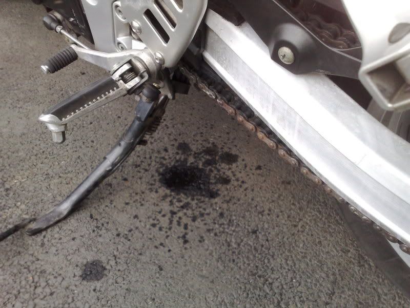

Had my curvy SV for a few weeks, out a run today and as i parked up and pottered about taking my helmet off etc i noticed this -

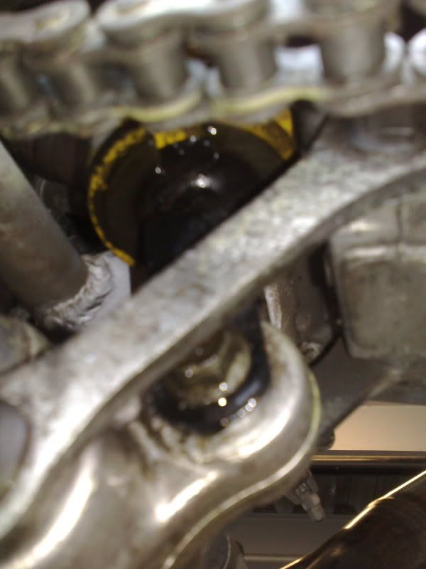

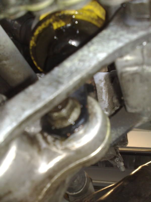

Upon further inspection it appears to be coming from the bottom of my rear shock and running down the shaft.... couple of pics -
Bike feels fine (damping) but i guess it could have just started) So, do you guys reckon it is the shock.. or could it be something higher and dripping down, if so any ideas?

Hmm, looks like some whatever it is on the outside of the spring. Certainly weird.
Woulda just suggested Chain lube excess but your chain looks like its either waxed/in need of some love.

Looking at the dryness of your chain I would say yes it is the shock. Maybe get someone to bounce on the bike whilst looking underneath and see what gives?
Apart from getting an aftermarket shock such as a Hagon, I do not believe there are other shocks out there that are a direct fit without the requirement of modification in some shape or form. Normally cutting of the battery box is required as a minimum.

I reckon the oil is coming out the top of the shock, so it will be a pretty slow leak sa oil will only come out when the shock is under stress.
