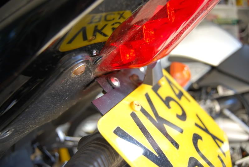

Yup!
mine did the same at speed.
So crappy motrax one for £10 + two garden fencing support things ( there a U shape).
Cut one side off spray black. 5 mins on drilling holes to match up with tail tidy which doesnt fit the sv. then bolts stright onto the bottom on the bike.
cheap and simple if you have 45mins to spare.
dead strong aswell.
will grab some pics if you want ?

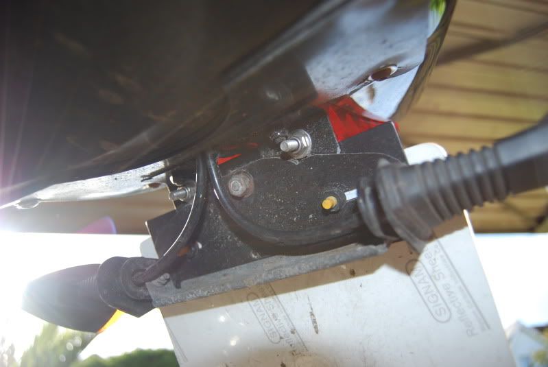

Ok wuick run down.
Top- standard plate with 4 bolts that is on underside of bike.
Down one- L shaped metal bolted to what was left (+ drilling ) of old tidy tail. the bit with the indies attached
infront of that:
If u can see the matt black corners thats the motrax one which is bolted on by the number plate light ( central bolt by the wires ) and two others either side above the number plate nylon ones.
another image for refernce.
i realise this could be explained alot better.
but if u can do this... only cost is around £12 excluding the new number plate i needed after the wheel melted its way through.
