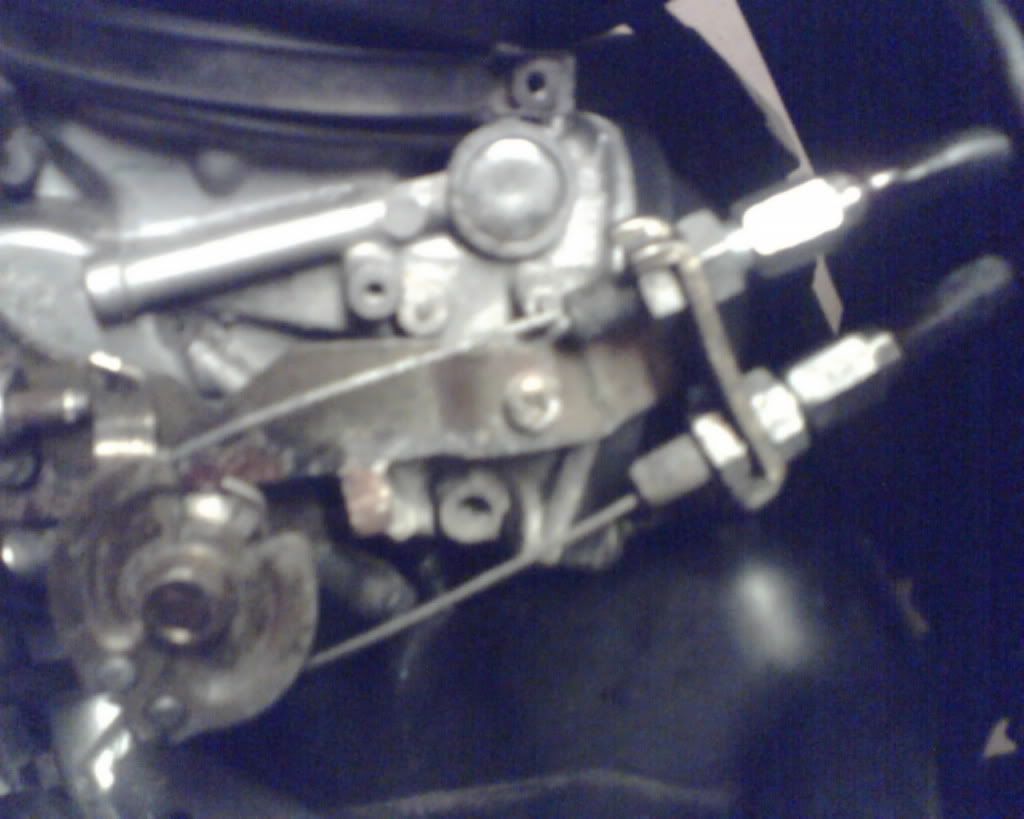

I'm really sorry all but I'm having a nightmare getting my head around these cables.
After swearing at them and at the Haynes manual all night my brother had a go and this is what we got to;
http://i567.photobucket.com/albums/s...v/Image070.jpg
The cables at the switchgear end are at maximum slack, i.e adjusted all the way in.
The throttle seems to be ok, I need to muck about with the switchgear cable to sort the slack.
- The closing cable (lower cable) has the adjuster pretty much all the way at the top (where the rubber cable outer starts). Does that mean there's no adjustment left in the cable?
- There's a lot of thread left at the left side of the bracket, more than when I took it off I'm sure. Do the cables need to be more towards the left of the thread to allow more adjustment?
- When Haynes says to move the adjusters in, is that moving them towards the front or the back side of the bike?
- haynes says that to adjust you need to slacken the locknut and then move the adjuster out to tighten the cable. Trying this the locknut moves with the adjuster instead of independently, is that right?
- the lower cable's captive nut (leftmost nut on the cables) isn't butting up against the bracket, does it have to be against the bracket to be secure?
- Does anyone know of a guide on how to install and adjust these cables?
I'm really sorry about this, the rest of the carb install/removal/rejetting/e-clips etc is no problem at all but I just cannot get my head around these throttle cables
Thanks again for your help everyone
