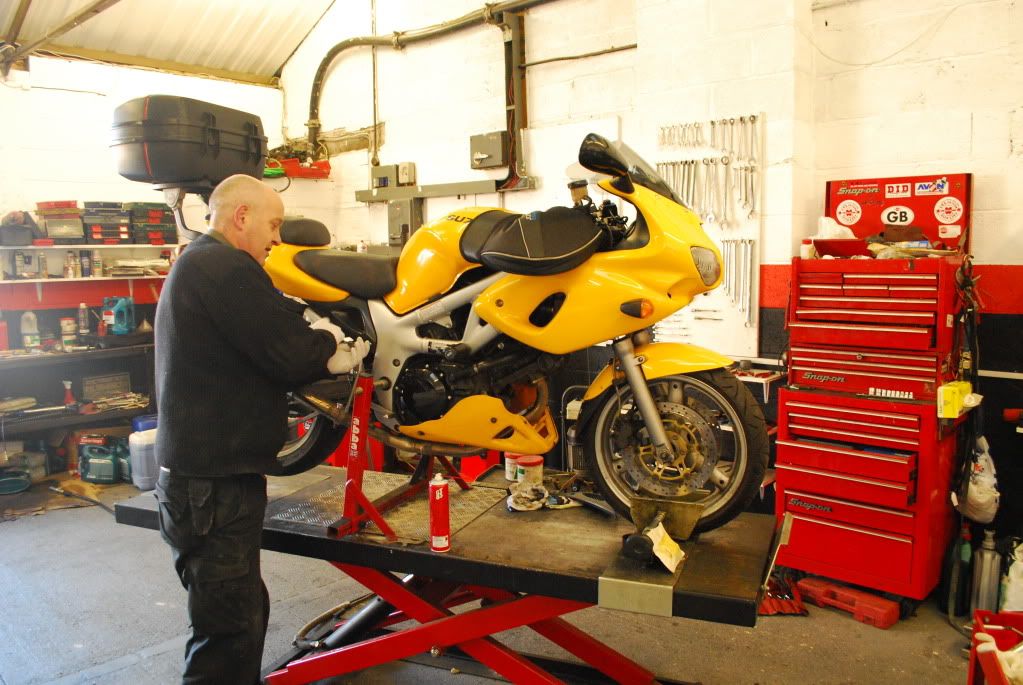

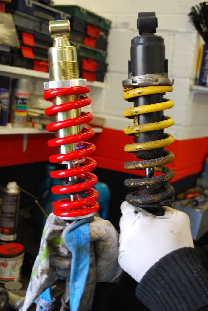

And today, Spannerman and his partner-in-crime, Billbo () took some time to fettle my rear end. Good bye old SV shock, helllooooo shiny shiny new Hagon rear shock, ooooooooooooooooooooooooooooooo
Spannerman applying his spannering skillz...blud.

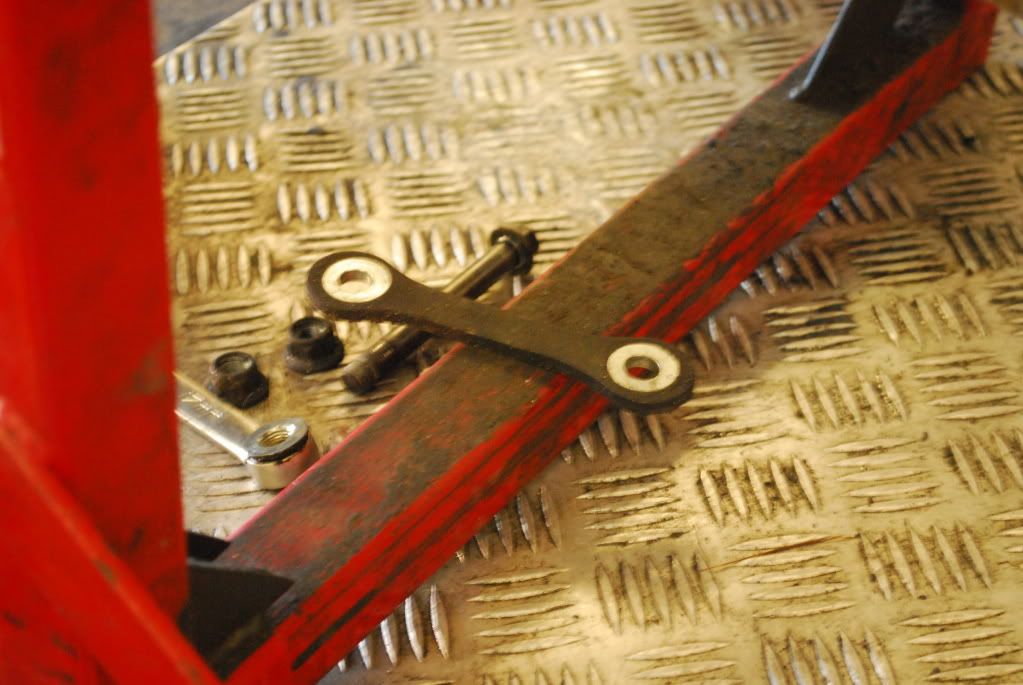

dirty dog bones

lots of this, because there wasnt lots of it present
new vs old
Just sitting on the bike, I felt an improvment; before, the rear end would compress, then return slowly. Now, the shock compresses and returns at similar rates. The suspension is harder aswell. Riding out, I feel less "pumping" action from the rear end, although I couldnt really test because I was cautious of unfamilier handling. I feel more confident with the rear end, like I know whats going on with the rear tyre.
Overall, I highly recomend throwin £500 at your SV's suspension if its old and tired. My bike now feels refreshed and renewed, similar to the 6000 mile bandit loan bike I had, which is the only other bike I've ever ridden.

missyburd
Default Re: A shocking experiance
sorry but is that Spannerman's garage in the first photo? It really is the dog's danglies of garages that one
Why has spannerman got a topbox bolted to his head?

Yeah £500 on the suspension, but I'd go for a proper shock rather than an emulsion type.
Only ones I would consider are ohlins for SRAD revalved (not the ohlins they sell meant for the SV!) or penske.
For penske double clicker, heavier springs, top quality oil, shims you are still under £500. Assuming you already have GSXR forks to play with, if not add a few quid on to fit some CBR cartridges in forks.
Hagon would be brilliant if they gave you choice of ride height and spring rate rather than just their own idea of a standard shock. Workable but nowhere near as good as ZX6/10R shock and not a patch on the SRAD750 shock (if you're light and not 2up).

YC; 250 for the rear shock, 60 odd for the front springs and fork oil (that also answers dirty dog). I also had headraces done (50 quid) and paid spannerman labour. So about £500 not everyone can do the work themselves, either through lakc of knowledge, confidence, working space or a combination of those
