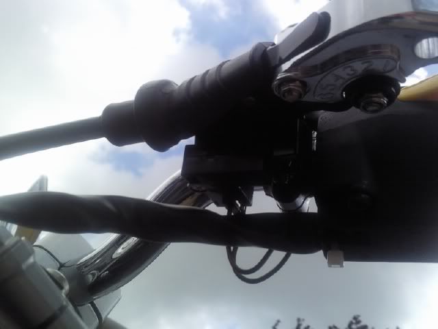

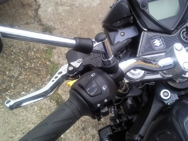

I was never gonna give up with the levers that many of us bought of ebay, meant for the GSR600.
And there was no-way I could justify spending £100+ on a pair of Pazzo levers either!! (GSR ones were cheaper than SV ones too)
So, the original problem with these is the different clutch switch that the SV has to the GSR....Plus the clutch lever perch/pivot area was different too.
I aquired a GSR600 lever, perch and switch complete......then swapped it over with my SV original, very simple job.
To get the grip off, just took the bar-end off and gently inserted a screwdriver and separated the grip from the adhesive.
Simples.

Cheers for posting that speedy, still don't know what to do with mine - thinking the perch'll look crappy with the hole for the mirror as mine is a faired bike.

Yeah, thats annoying.
What about a slightly older GSXR perch??
