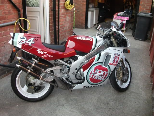

I have just done a ground up restoration on an RGV 250 and that cost me a lot. Bearing in mind that compared to a GT250 they are pretty modern.
Problem I have found is that 2 strokes are so addictive to ride. Here's mine if you want a bit of inspiration!
