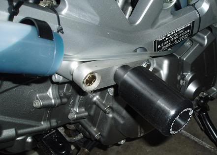

I've just fitted one this weekend I put a bit of effort in, and managed to mount the 'devlivery head' (aka ty-raps ) behind the swing arm. I also formed the wire so that is behind the swing arm too. All you can see are the two ty-raps (Mr. Loobman must have shares in 'em). When I get a chance I will post some pics.
I mounted the bottle under the subframe, under the triangle plastic bit. It is vulnerable to a bit of fling... but I don't think it looks too bad.
It's early days for me, but I would say I have the opposite problem... as in not as much oil is delivered as I would have expected. Even though I can't resist giving it a squeeze to make sure it's working (oo-er missus). I don't think the tyre looks any worse than with my old spray lube.

Fitted mine onto rear pillion peg mount (as per Loobman website pic ). I agree that the chain does look nice and shiny, so it is obviously getting loobed

I've stuck the bottle up by my knee so I can still reach it while on the bike...
god it looks ugly... but the chain looks as good as new, although it was rust-covered and minging when I got the bike - dealer degreases the bikes to keep the floor clean. I'd expect it (and the sprockets) to last for ages, even with winter riding.
