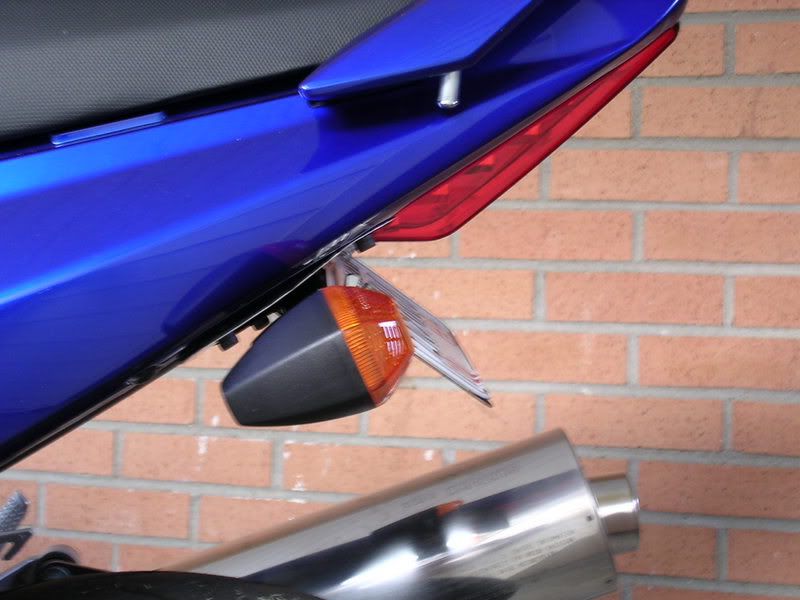

There is a good template and instructions in the "FAQ and How To" section on the site main page. This is how it comes out.

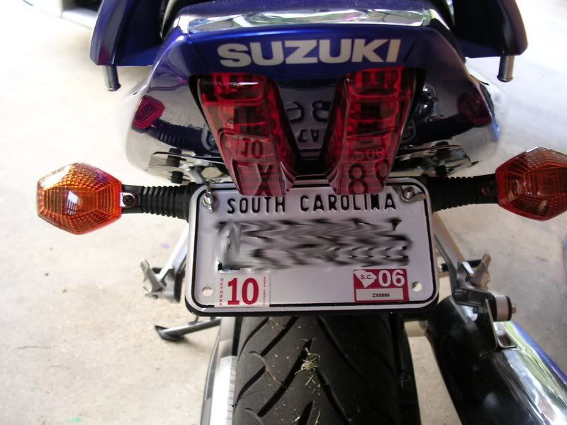

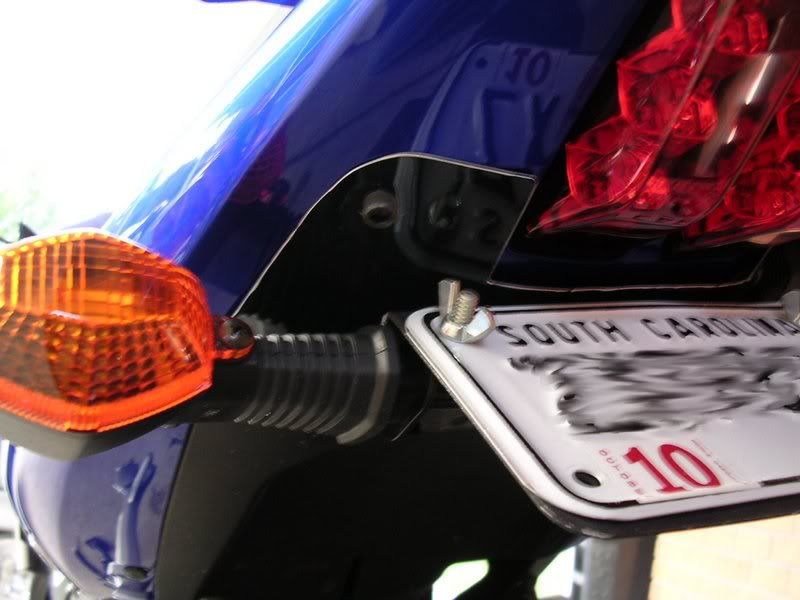

this is my final product. the metal is kind of thin but it does the job.
