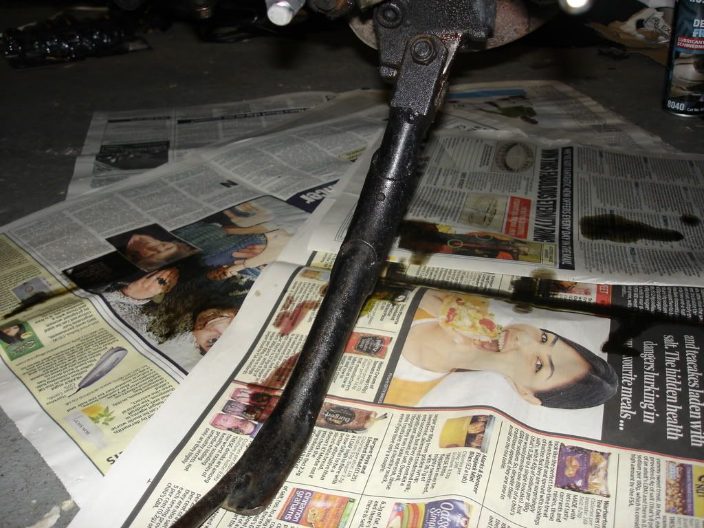

Ok further to my other messages took some pics of the oil drips so we are not talking about a little bit of oil( i know a little oil goes a long way, but even with that).
oil level is definitely ok so looks like back to shop.

Assuming you don't have a chain oiler pouring too much on the chain I would take it straight back to the dealer.It may be a crankcase breather issue,but it could also be coming from the rear cylinder head gasket or the gearbox output shaft.Either of those will require some work to fix.
