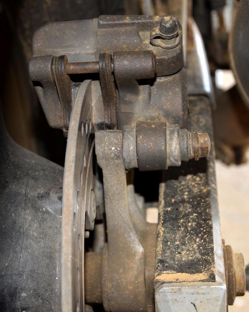

the rear calliper only has 3 anti rattle/squeal shims. 2 are on the pads and the other is on the main carriage and the pads locate into it. now you could have disloged the carrier rattle shim as they are a PITA which might be causing the carrier to jam. other than that the rear brake on the pointy is a very simple affair and not much to go wrong.
can you post a few pics at different angles of the calliper on the bike?
aesmith 01-07-14 06:09 PM
Re: Rapid, uneven rear pad wear
Not very easy to get any good angles, but for what it's worth. (By the way, most of the rust-brown is dust from the farm track)
http://i42.photobucket.com/albums/e3...ps360cd760.jpg
And
http://i42.photobucket.com/albums/e3...ps4dac5cca.jpg
Bibio 01-07-14 06:23 PM
all looks fine to me. those pads are very thick.
your chain adjuster ends are the wrong way round though.
aesmith 01-07-14 07:09 PM
Cheers. New pads just fitted, and there's only just enough room with the piston fully retracted. Can't remember the brand of these pads, they were the cheapest I could find just in case it rips through these in the same short time.
Will have to see what I find with a proper dismantle, I have a spare rebuilt calliper as well so could swap that over to rule out sticky piston. Also wondering if it could be wear in the sliding parts, so they move freely by hand but go slightly squint and bind in actual use.
