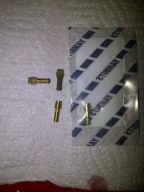

Took the carbs back to Rolling Art to be ultrasonically cleaned. Glenn apologised for missing it the first time, but its no bother as I had missed it too. Anyway pilot jets removed and the carb recleaned I pick them back up.
http://i153.photobucket.com/albums/s...ps6d2eff08.jpg
Decided that new pilots would be best considering the state of the originals as can be seen above, new on the bottom, old on the top.
So blasted them out with air. Rebuilt them and stuck them on the bike.
Slight problem. Cant start it now.
At most got a couple of tiny puffs and that's been it. Choke on, off, open throttle, closed throttle. Nothing.
Swapped plugs. Checked their spark. Nothing. There is fuel in the float chambers.
Ideas please?
