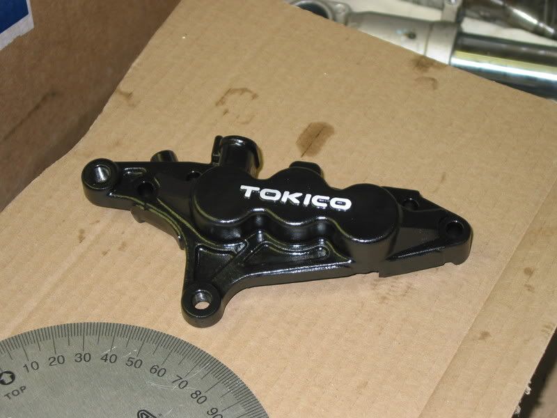

I've got a sv650s with gsxr front end and six pot calipiers with braided lines but brake has long travel so could someone advise on what size brake master cylinder is fitted on the gsxr.

If the pistons are not clean, the dust seals will drag and pull the pistons too far back into the caliper.
Is the lever hard once it has taken up excess travel?
Which 6 pots are you using? The 'busa ones or GSXR1000 ones?

Keep the seals, just try strip, clean and reassemble with some rubber grease.

Think they are the gsxr one's, didn't buy them myself I bought the bike in bits on ebay last year.

GSXR750 96-99/'busa/'TLR/ZX6R
GSXR1000K1-K2 #not certain match# but that shows the different shape with the bottom mount much closer in to the pistons and not having the triangular profile.

gsxr 750 one's cheers
