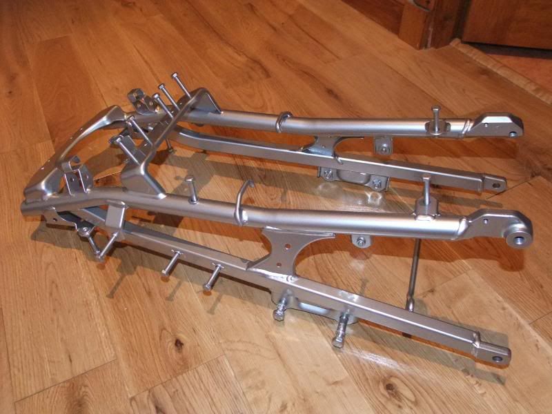

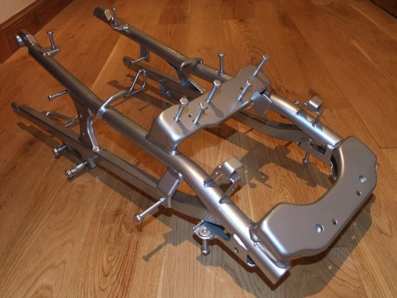

Just got the rear subframe back from Coatech in Carnoustie. Still warm from the oven It was only £30
I asked about getting two tone wheels but they said the extra labour puts the price up from £50 per wheel to £100 per wheel. The other options are to get the base powdercoated in one colour then just paint the other bit. Or get it vinyl'd then lacquered. OR they can do two tone but instead of having clear lines between the two colours, they blend them together, which brings the price down to £70 per wheel. And the last option is to have one part polished and the other part painted or lacquered, but I'm not keen on that because I don't fancy polishing it all the time.

Nice!
Had a few bits from my Silver Curvy done in a similar colour. Good that you left bolts in the threads, as powder coat is a bugger to cleam out of the threads ifyou don't!

Nice!
They actually put the bolts in for me
Old 21-12-09, 04:53 PM   #4
Default Re: Powdercoated
That's the sign of a good powder coating shop. Mine used bungs, which are good, so I just had to run a tap through to clean up a couple of threads.
