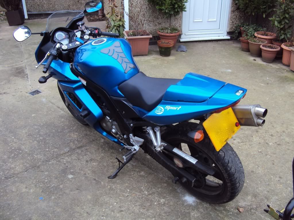

Can anyone give me some advice on respraying this seat cowl I've spotted on ebay.
I've never done any respraying myself nor do I have any equipment or even know what I would need to purchase to do this myself.
So could I have some opinions on which would be cheaper. Obtaining all the necessary gubins and doing it myself or, paying someone to do it for me?
Cheers guys.
By the way, if it matters my bike is an 06 SV650s Blue, see below.

Maybe its just the angle of the pic but that tyre looks squarer than sponge bobs pants
Old 28-04-11, 09:22 PM   #3
Chris Bird
Default Re: Respraying advice please.
It's the angle

Hi Chris, actually your current cowl looks amazing! Lol.
