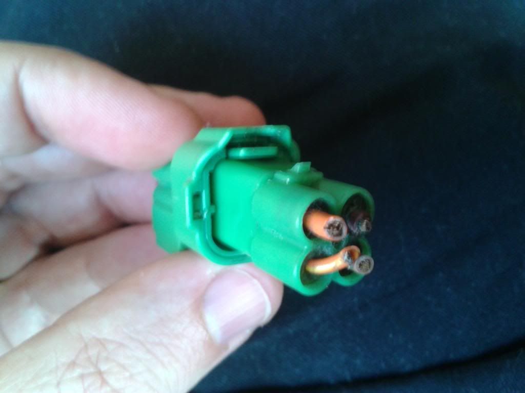

Was a pain to get to but I did have another look today, maybe a couple of small scorch marks on the outside plastic but it didn't look fried, not really sure. Wires going in/out seemed fine and jiggling things around didn't help.
Q: How is it meant to come apart, just those little tabs? Maybe the fact it didn't want to budge is a bad sign...

Lift the one tab, as shown, and pull apart:
