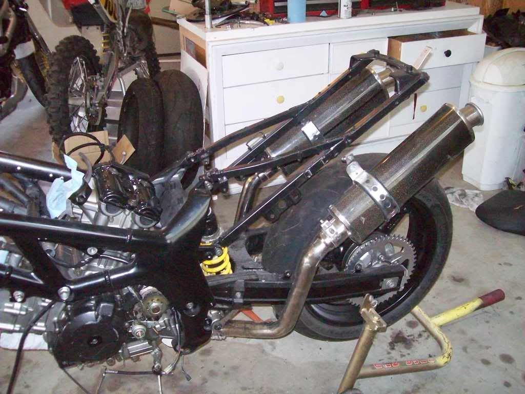

What kind of jetting are you guys with dual renegades running?

From what I have read:
desnorkle
152.5 mains
17.5 pilots
2 Shims under needle
2.5 turns airscrew
Drilled Slides
if your running pod filters:
160 mains
3 shims under needle

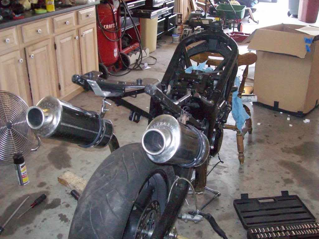

I got them mounted up today but I still have plenty of time to get it jetted before the bike is ready to ride.
