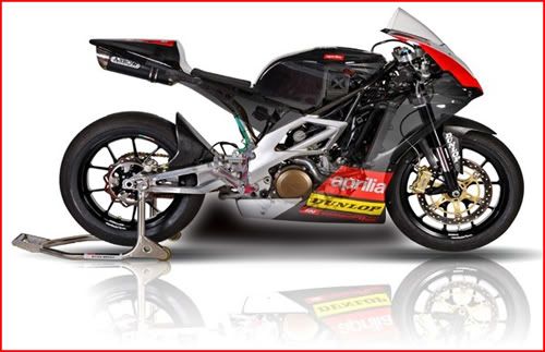

Aprillia RRV450

I have a Hyosung GT125R which is a v-twin and is actually a very good engine, they also do a 250 v-twin. Their engine are based on the SV.
But that RRV looks NARCE. would have saved my tonnes on insurance seeing as I'm only 18!
