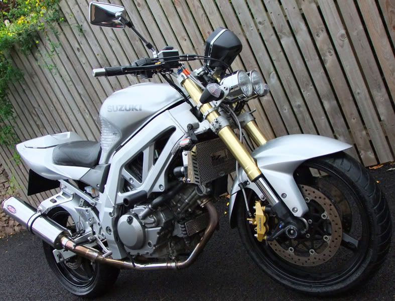

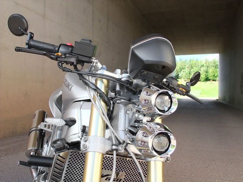

I mounted my clocks on a bracket fixed to the ignition barrel bolts. Dunno if that would be possible on your bike?
For the headlight you'll need some fork clamps like these http://www.mandp.co.uk/productinfo/5.../On-Two-Wheels
I hid the wiring under the tank, behind the steering stem.

There should be a mount on a headstock and you can fabricate a mount from Ali to strap the clocks to
That could interfere with the cables on full lock
Where did you get that bracket from? The one for mounting clocks from ignition barrel bolts!! That sounds ideal!!

I made the speedo bracket out of aluminium sheet. Think it was 4 or 5mm thick.
Works well with the sv speedo because most of the bracket is hidden by the plastic cover
Is it like a dominator light you have then? With my new lights I mounted them to the frame mounts with that alu sheeting.
