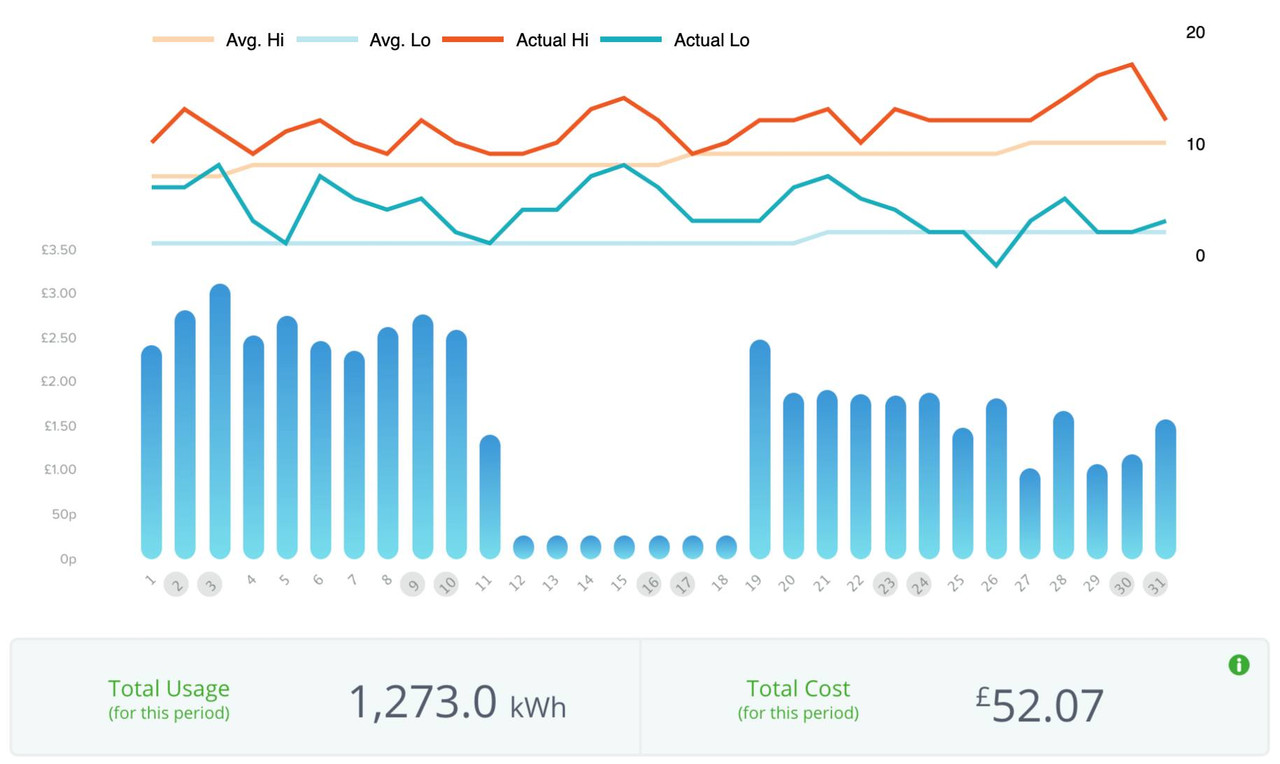

I'm entirely happy with the boiler. The Honeywell thermostat works pretty well, and I can control it from my phone remotely, which is nice. I worked out it'll save a fair amount, too. I'll post the graph if I can find it.

Edit: here's the graph of my gas usage. The weather was getting a little warmer, but I do think it'll save me money long-term:
