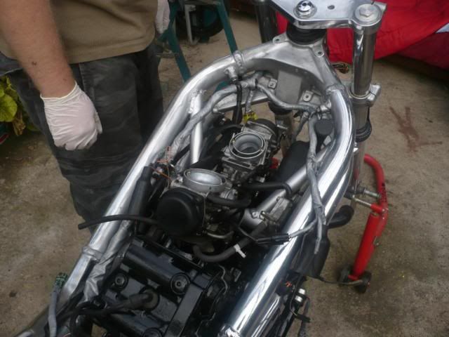

todays progress!!!
the aim for today was to hopefully get her running again as starting to get withdrawal symptoms now with her being in pieces.

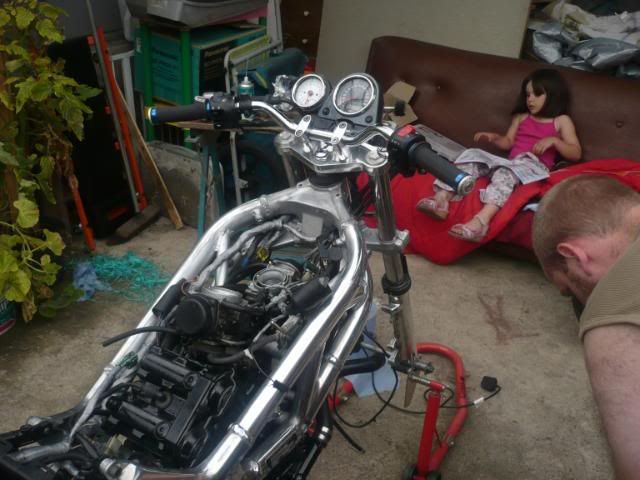

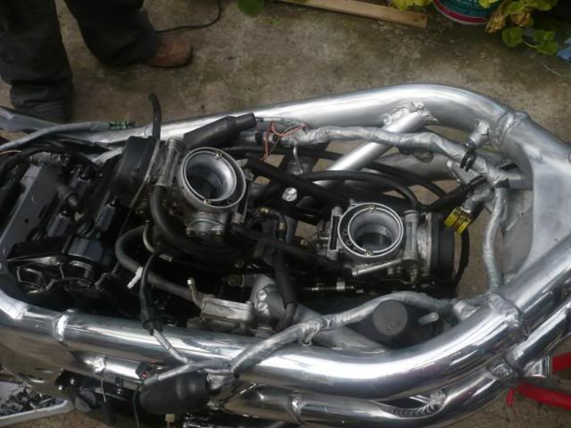

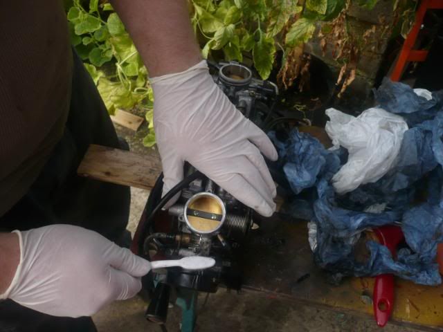

i started off by cleaning up the carburettors and refitting them.
then reconnecting all the cables and hoses, and the radiator, horn and cooling system.
I've taken the sv stainless steel radiator cover off for polishing as that can be refitted later on and also gave my horn a good polish!!!!

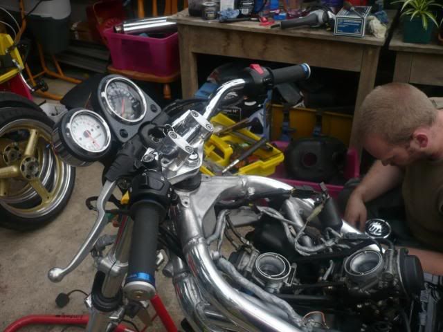

then next job was going to be fitting the handlebars but i had to polish up the handlebar mounts first before refitting them so yet again, more polishing!!!

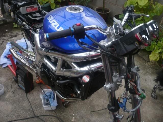

then began to refit the handlebars and all the switches etc. that go with it and had a bit of an accident when trying to refit the clutch lever!!!
as i was tightening the mounting bolt it decided to be really inconvenient and snap on me so i now need to replace that next time i get chance to go and fetch one from the shop.

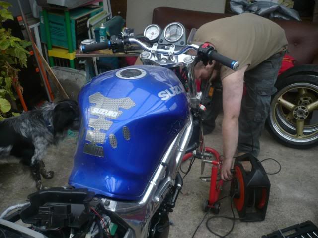

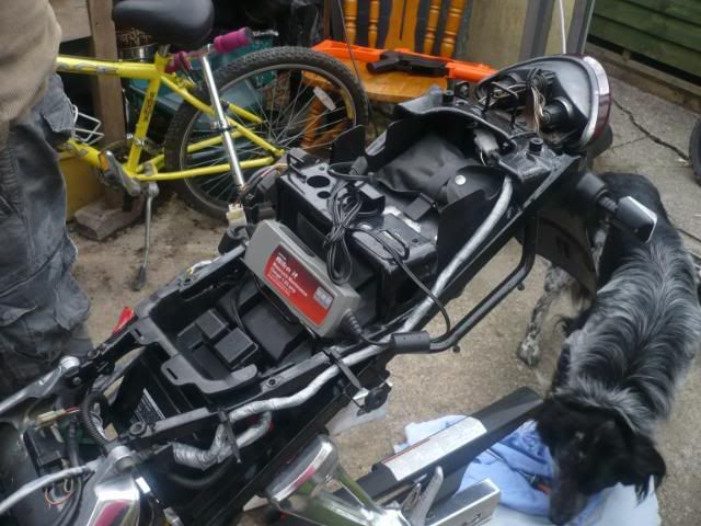

so with everything reconnected thought the next step i should take is checking the battery had enough juice in it to turn her over and shock horror, it's as flat as a fart so i had to put it on charge(delaying my plans even more)
oh and excuse the mutt in the background, typical dog is always in the way.
so left it while we had tea and sorted kids homework out etc. the usual crap for a sunday evening and afternoon and then went back out and fitted the fuel tank on just for now so we could try and turn her over.
you'll have to excuse the blueness of the paint for now as obviously everyone is aware that it will be changing.
