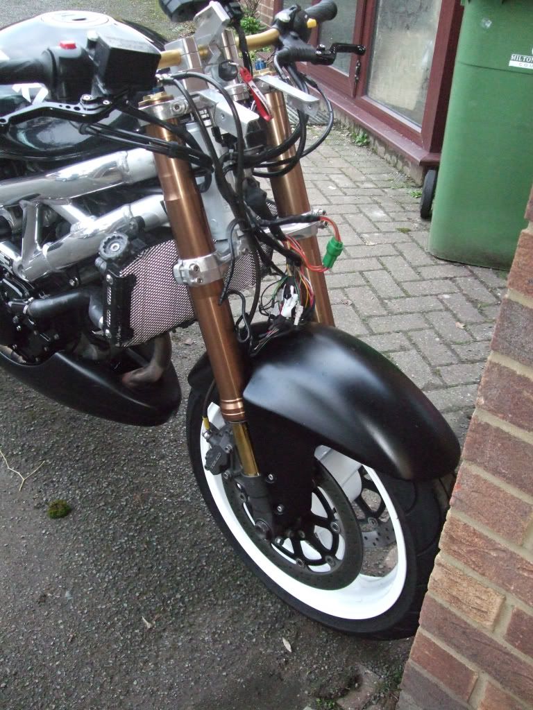

Old 23-09-12, 10:02 PM   #139
phil24_7
Default Re: GSX-R Front end conversion
This was taken a while ago but is basically what it looks like now. The old difference is that now it is a little dusty and is wrapped up in an Oxford Stormex in my garage as I haven't had time to ride it this year!
