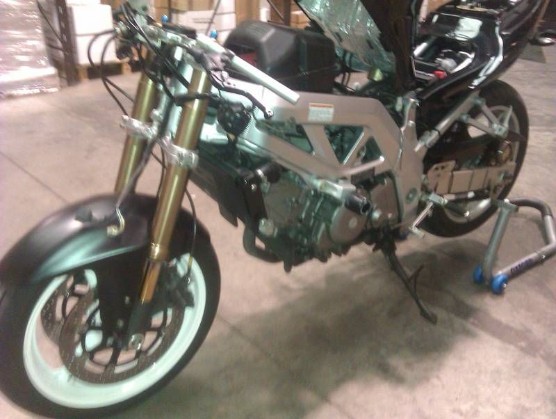

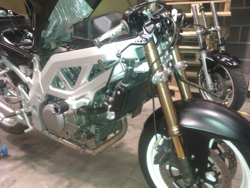

Made a good start on my swap today so the front is mostly installed just got to set up clip ons and controls and fill and bleed brakes before I reinstall the clocks and plastics.
I've had a couple of little problems, on the left clip on the brake doesn't quite go over enough to allow the indicator control to locate in the hole on the clip on. My 2 solutions that I've yet to do are either file a tad of the clip on away or to get rid of the locater pin on the controls, what do you think is best?
The other one is the brake line screw doesn't seem to want to go into the master cylinder without a lot of force so I've left it for now, is this normal?
Other than that its gone well really, here's where I'm at.
