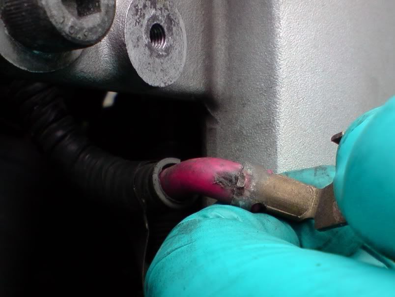

Well I was speaking to Sarj about this and he said it looked and sounded like the earth cable breaking down. In addition to the flat battery I imagine that didn't help, as once the engine gets warm and the load increases the cable just can't take it. Which will also explain why some morning the bike will not start with the lights on.
When we took the rubber cover of it was a right mess, and for a 10mm bolt it no longer fits a 10mm spanner. So for my journey home Sarj helpfully put on some mains cable to help spread the load and I seem to have been able to get home on it. When this rain eases off I will have to pop the earth of the other bike and use that in the mean time while I source another.

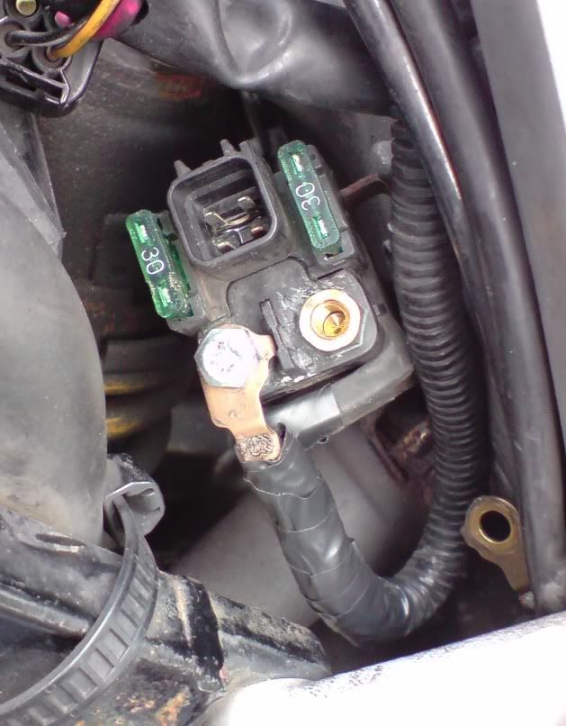

Looks like after swapping the earth cable off the other SV and having rather a fight with the nut, that involved turning a 10mm nut into a 8mm one. I seem to have found another source of the problem.
When tightening up the screws on the start relay I got a whole load of sparks, which was odd as there was nothing that was loose. Then I noticed that live feed was touching the mounting for the relay. Could this have been my problem? So insulated it all up and hopefully it will sort it all out.
Old 30-03-08, 09:25 PM   #20
Grinch
Default Re: Four Breakdowns, one Bike.
Here's a few photos of the problem -
