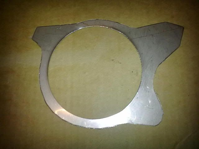

next stage well underway, ive made up a new bracket to mount the uk spec projector light into, this then fits onto the standard headlight aim screws, will drill these holes tomorrow at work.
all going well should be able to put the headlight back together this weekend.
Lee

Ive now drilled all the mounting holes, and fitted the projector light to the bracket, which is fitted to the headlight rear cover.
Because ive had to make up the bracket,and using a car projector thats bigger then the sv projector, im thinking of test fitting the headlight, minus the lense and making sure it aims correctly, before mastiking the lense on. (the lense in front of the projector is clear, so shouldnt make any real difference without it, just want to make sure it aims ok)
Piccies to follow soon.

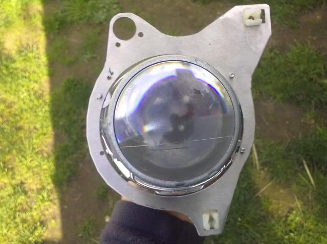

Old 30-09-10, 08:29 PM   #15
leebex
Default Re: next phase of the projector light project.
car projector unit now fitted into the headlight mounting bracket. The headlight is shown as it fits into the rear casing. Adjuster screw pastic nuts also fitted, headlight seems to aim as it should but cant be sure until its fitted in my bike.
Will fit just the rear casing in first to make sure it aims ok, if it does I`ll then glue the lense on.
Ive used cap head screws to fit the projector to the bracket, so if I run out of adjustment, or the projector isnt fitted level It can be spun clockwise or anticlockwise as needed, and used the cap head screws so I can get a ball ended alley key in, its a little tight past the headlight, as its bigger than the proper sv one.
Lee

Old 07-11-10, 04:16 PM   #17
leebex
replied to your pm mate still got the original.
Fitted the headlight today and connected it up, woohoo it works as it should, cant tell if its aiming ok as bike on axle stands in the shed though
And the pointy rear light all works too, now to get it all put back together and tidy up the rear end
