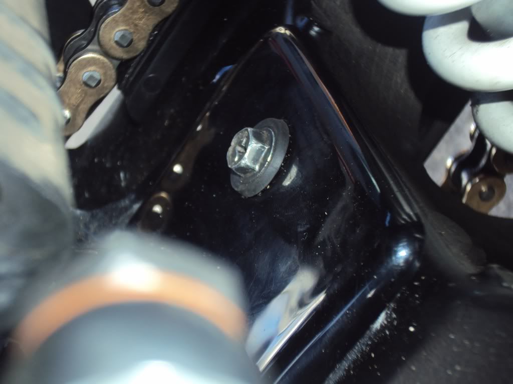

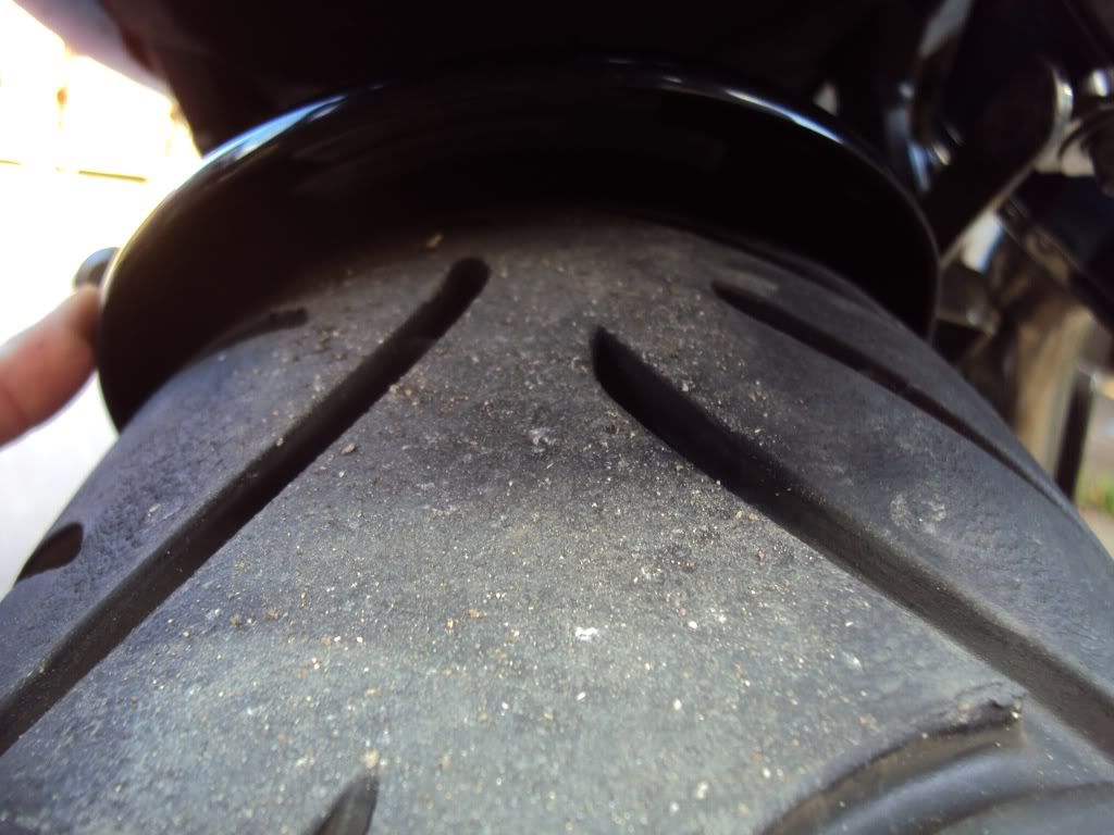

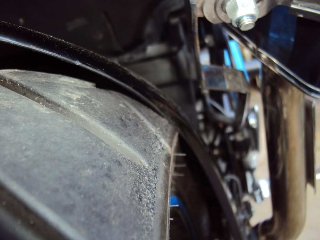

This is how the hugger sits naturally
There is only a small difference in how it seems it should sit
Bracket and own spacer trial
Front mount
Chain guard mount
Any ideas welcome.

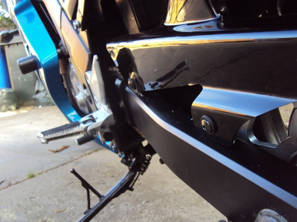

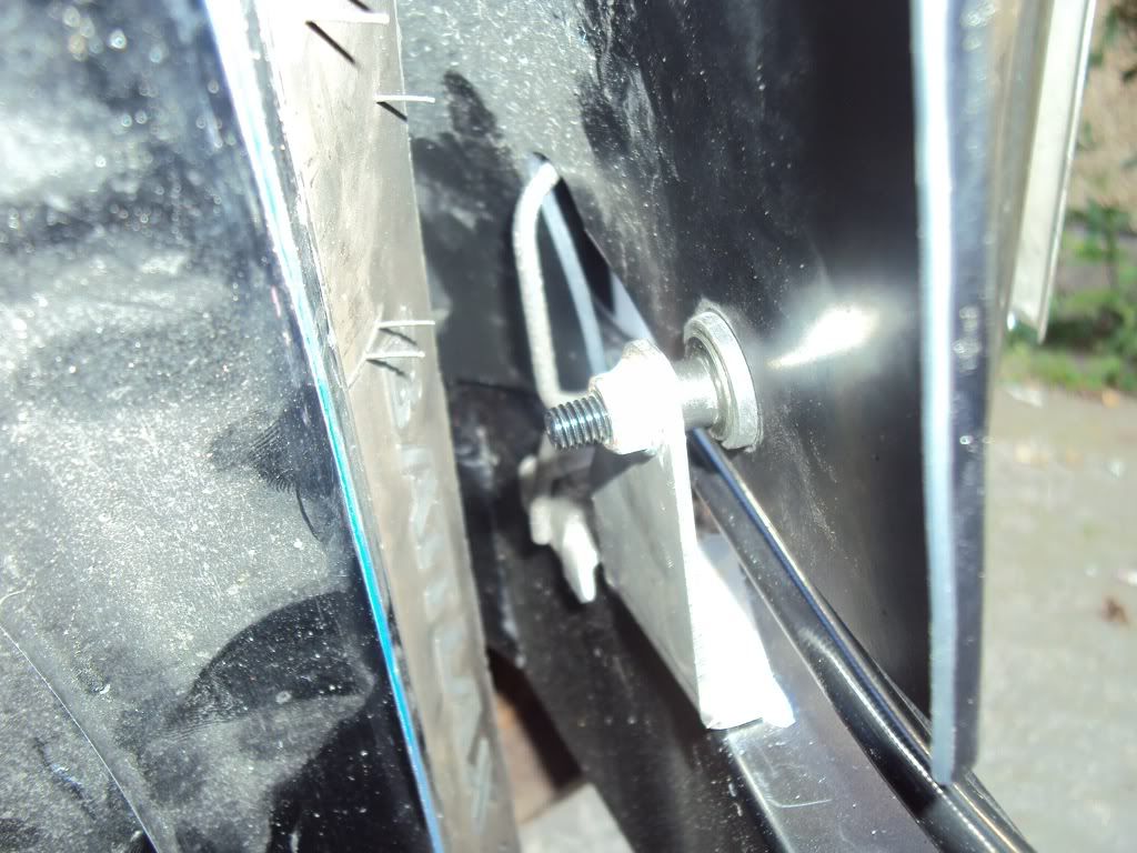

Mine did the same but on the chain side. I ended up putting a small length of flat bar behind the bolt and hugger to push it straight (it worked for me) or can you alter the angle of the bracket outwards without damaging it, that might move it away from the wheel.

I think I'll give your flat bar idea a go tomorrow, will need to find one first. Did you secure the bar at either end and drill a second hole in the hugger or use an adhesive or anything like that? Or was the one fixing enough?

Heres some pics of what i did. Just the one hole for fixing. Bar length was just enough to move/push hugger away from wheel and straighten hugger up. Ali bar was cut straight so the swingarm kept it at the right angle and it couldn't swivel in situ, (if that makes sense as im rubbish at explaining stuff as im a hands on guy)
And below is a pic of the hugger (a while ago) and you can just make out where it rubbed on the tyre and wore a bit away pre fix.

Cheers for help dudes. That idea of yours worked geodude but then I got snagged by the fact that the hugger would of hit my exhaust hanger going over any bumps. I've got a high level on mine at the moment and the hanger goes round the back of the exhaust....I think I'm gonna sell the exhaust and possibly the hugger too. Haven't decided yet...
