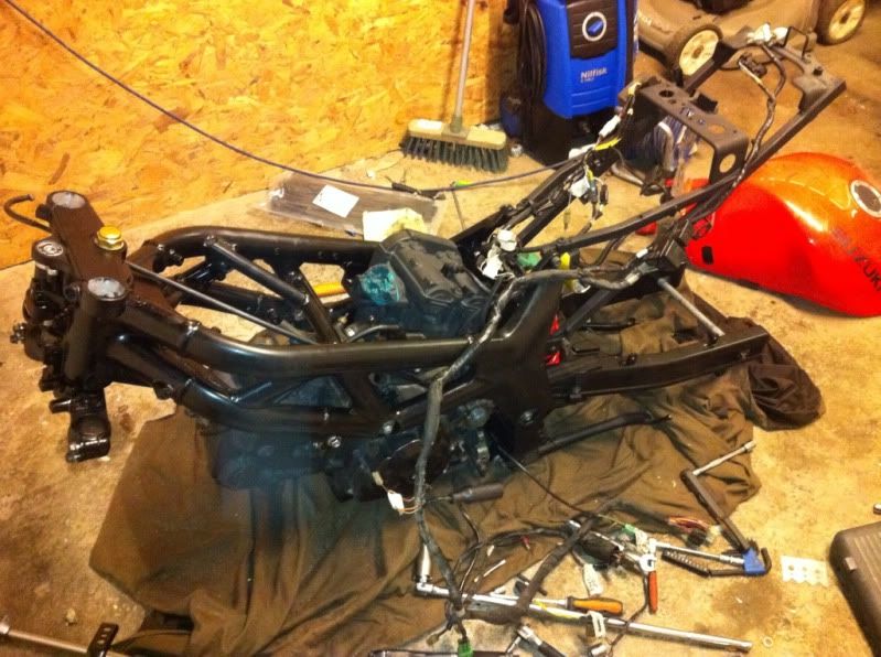

Old 05-11-11, 05:21 PM   #13
srobrien
Default Re: The Red Barons update page!
Small update....
Frame and Swingarm back from powdercoaters, excellent job.
Fitted new swingarm bearings and test fitted to the frame.
Dry fit of my ZX6R rear shock...ebay bargain at £40!
Modified my rear subframe to get rid of the tie down points and the pillion peg brackets (left half of one bracket to fit the high level exhaust). And given a few coats of satin rustoleum.
Managed to absolutly MULLER my exhaust trying to remove the stubs etc from the head..will have to send it off to a machine shop to get it sorted!!
Should get the brakes and shocks stripped down soon to send off to the powdercoaters.

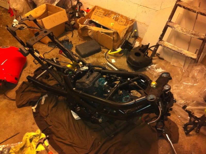

Sooooooo, I set about fixing the broken studs in the head, which was actually easier than expected. Managed to drill and retap them will little problem, fitted and secured the new studs.
While the engine was out a gave it a good scrub with various brushes and gunk degreaser. Then a few coats of Hammerite matt BBQ paint, which came out nice.
I then printed off the service manual (at work of course) and managed to decipher the instructions to get the engine back in the frame.
Then went in the start of the wiring loom
Then I realised I had trapped the alternator wire between the bottom of the engine and the frame
Then I got mad
Then I smashed some stuff up
Then I smashed some more stuff up
Then I cried a little
Then the engine came back out
Then I moved the cable
Then the engine went back in
And.......then I gave up for today before anything else got smashed up.
The bearings and tyres are off the wheels waiting to get powdercoated along with the sprocket carrier and the brake callipers (if I can get the sodding pistons out!)
So getting there slowly.

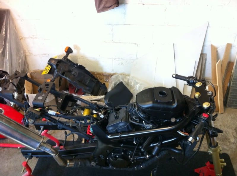

I am undecided how to finish it though..do I put the full fairings back on or do I streetfighter it? I like the SF look but can't be arsed putting handlebars on and fiddling about with the wiring.
Has anybody Streetfightered with the standard clip-ons?
Thanks for looking
Aye, cafe racer stylee FTW.
You'll need to sort out a headlight and brackets, which is pretty straightforward. You'll also need to fab a bracket for the clocks and then decide what you're going to use - originals look a bit untidy on naked bikes IMO. SV Naked clocks look better (hen's teeth though) or something else like from a Bandit. Or aftermarket jobs if you're feeling spendy.
You will be messing about with wiring and there's a lot of loom to hide.

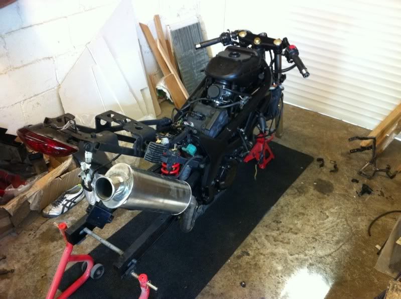

Re-fitted my newly blinged forks, 99% of the wiring is done, just needs tidied up.
Clip-ons finished and cables attached.

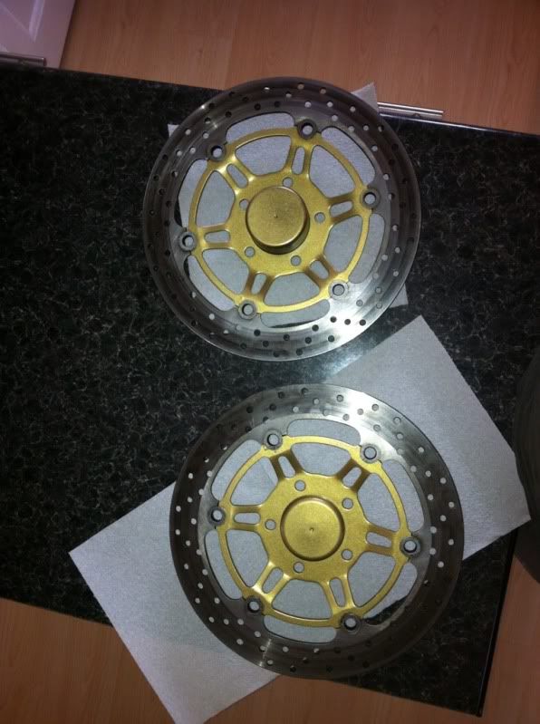

Whilst I had the hammerite out I thought I would give the rotors a quick spruce up.

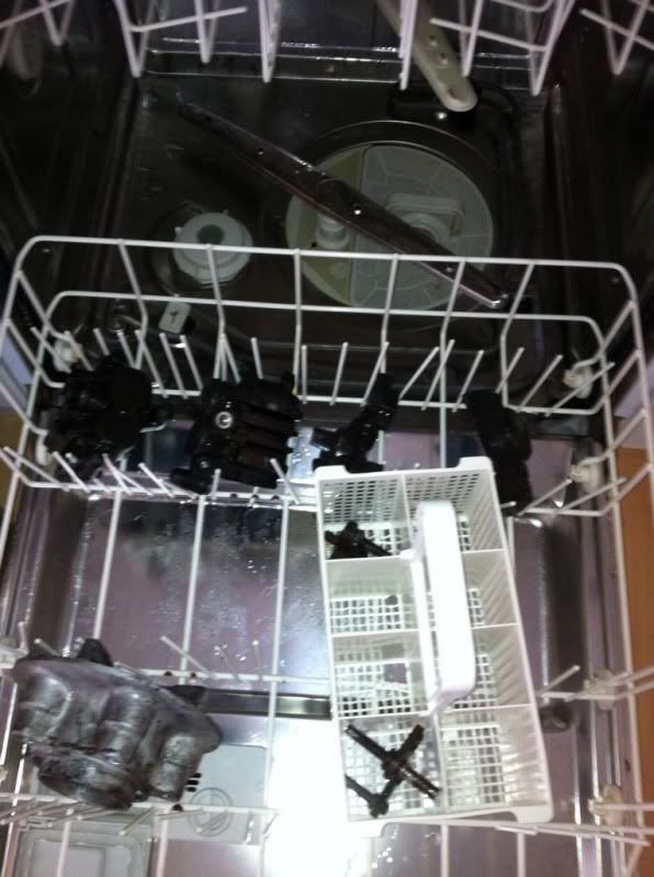

Brakes stripped down, pistons and seals removed.
Who needs a parts cleaner! (can you tell the missus works during the day!)
Managed to wreck all the pistons when removing them but I had planned on changing them all anyway...what I hadn't planned on was them being £23 EACH!!....wish I had known that before I went crazy on them.
