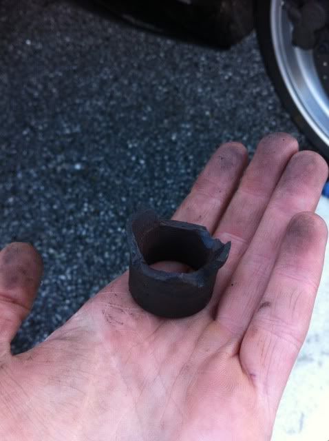

Old 02-05-13, 03:33 PM   #16
Rogue_Shadow
Default Re: Front Wheel Removed, But What's This?

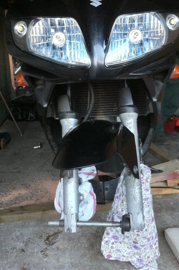

Repaired mine on Tuesday
While looking at the bike from the front, on the right hand side follow the fork down and you'll see a cable feeding a black rounded unit on the inside of the wheel.
This is the Speedo sensor, when you pull the wheel spinal out it separates from the wheel.
Inside the housing of the sensor is a small cylinder with 4 prongs
(unless it's naff ), this part separates from the housing.
This piece is called the "speedo sensor rotor", it's a magnet and the prongs line up with similar indents inside the wheel.
Hardest part is propping up the front wheel, otherwise it's a simple swap.

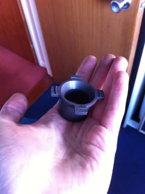

Got mine through Suzuki, 24 hour delivery for £20.
Judging by the broken rotor that crumbled out of my speedo sensor, unofficial types are available. But comparing old to new, the Offical Suzuki part was of a higher quality and had a snug fit inside the sensor.
Old (No surprise why it's wasn't working)
New
Suzuki part number: 34983-21e00
Old 02-05-13, 07:48 PM   #17
Sid Squid
No, I don't lend tools.
Sid Squid's Avatar
Posts: 8,680
I rather doubt that, I suspect the more recent parts are not of completely identical design, they are of course dimensionally similar, and made of a similar material.
As it's made of a relatively soft material, once it's damaged I'm sure the remains get a battering as the fragments swirl around in there.
