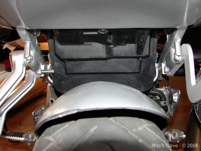

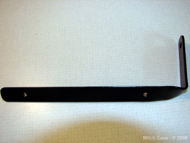

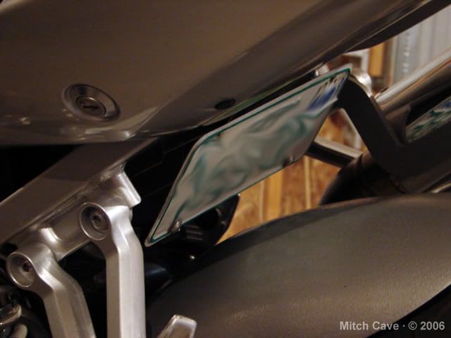

I decided to mount my license plate different than what you did:
Hotbodies Undertail Installation:
Originally Posted by www.MITCHCAVE.com
... The new undertail came with some 'high tech' mounts for your license plate. Simply put, they were crap. Unlike Hotbodies' recommendations, I didn't want to drill holes into this new/expensive piece of plastic. So, I looked for a new option. Pictures 8 through 15 show the details of this DIY custom license plate mount. In picture 8 you see two lengths of bolts. The shorter bolt is the Suzuki stock bolt for the passenger peg. I picked up a longer bolt from Medicine Hat Motosports. This allows me to make a custom mount and bolt it into place on the passenger peg bolt. A strip of metal was taken and bent at a 90° angle. The shorter end of the mount was bolted to that long passenger peg bolt. Then, the metal was twisted so that the license plate would fit between the rear wheel/hugger and the new undertail. You can see the bends and twists in the metal strip in pictures 11 and 12. The last 3 pictures show how close the license plate is and that there is very little room for error. The fit was pure luck.
8
9
10
11
12
13
14
15
Thank God for small license plates!! (I had to rub that in...)
