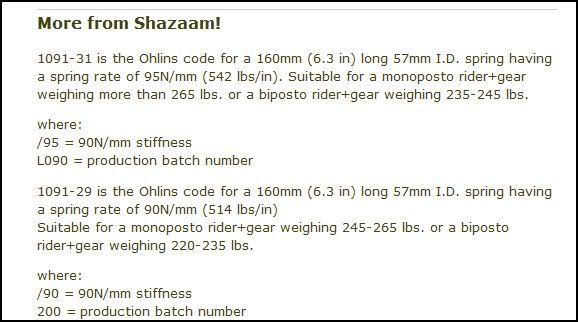

The other thing is, the spring on the Ohlins is labelled 1091-31/95 L471, just spoke to MC technics, they say, it's rated for 1-2up riding, for roughly 150-180kg... I'm ~80kg... will be taking the shock for a re-spring in the winter.

More details here
http://www.ducati-upnorth.com/tech/suspensionspring.php
Buy a spring and change it yourself Dyzio. You only need the tool for winding down the preload if it's the same as mine

From I've quickly read there, I think I would need a spring around 70-80Nm (I'm riding solo 95% of the time)?
