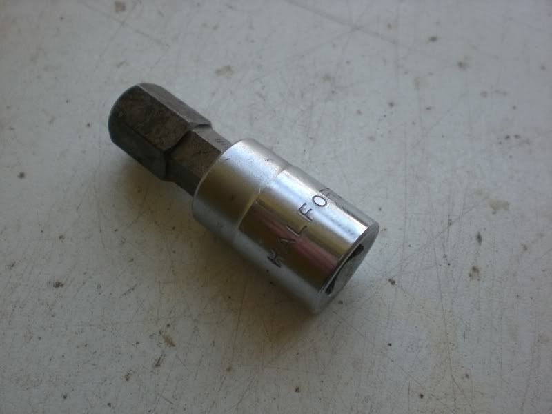

I think i am going to do exactly that mate, i am going to book into JHS in Bristol to do it. Only because i want them to set my suspension up properly to me. Ill get it done when i have fitted the new bits to my bike. out of suriosity what would be the right tool?? as i have seen tourqe wrenches but not ones with allen key attachments.

petevtwin650
Default Re: Neio79 Down!!!
Neio, at most good motorfactors, you can buy an allen key set in a socket. This will allow the use of a breaker bar to undo the bolt and a torque wrench for tightening it. They are about 7 quidish IIRC. This is a 12mm key in a 3/8th drive.

Pete, cheers, i will have a look in Halfords today for them, so one of them a breaker bar and a tourque wrench will do the job?

The bolt will be tight due to a high torque and quite possibly a thread locking compound. Be very careful as you apply pressure as you don't want anything to slip and you scratch the frame too.
