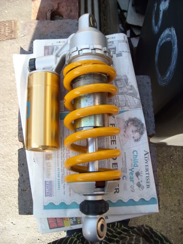

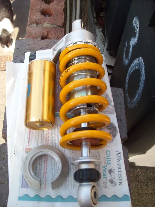

Just took a couple of pics as mine was out because it was leaking. K-Tech sorted it and a jammed rebound needle this morning.
I run 25 mm of preload on an uprated spring
Both rings at the top, and spring is free. You may need to pull on the shock to fully extend it Dyzio.
Collar off. Spring just slides down. Easy.

One more thing, I'm ~80 kg in normal clothes (nokia says it's 12.59st), did I guess the spring rate right (80Nm), and where do I get one?
